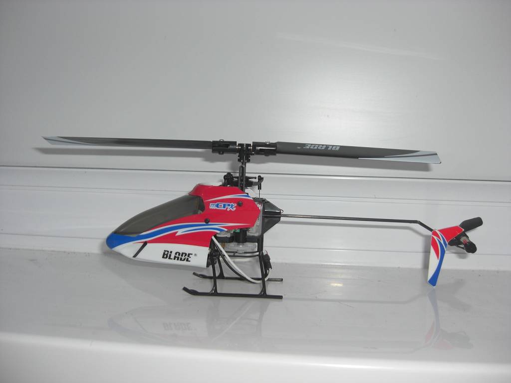

I have been trying some new moves with my MCPX , i was out of control snapped the throttle closed it went to neg pitch and snapped the tail off ,
Its no big deal parts dont cost much but my LHS has no tail booms in stock ,
anybody know of a quick fix on my tail till the new part comes ?
thanks in advance
phil.

You might try to CA a carbon fiber rod along break. You will have to add balancing weight in the front.

guys have been fixing the tail boom by replacing it with a 2mm or 3mm(can't remember the size) solid fiber rod and running the tail motor wires on the outside.
