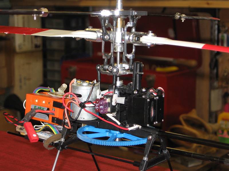

put fuses on the motors to protect the rx, I went with the full cnc head, Helidirect main gear and shaft, lipo monitor, dual tail motors, plastic blades, helidirect tail fin, thats about it.

For my 2cents worth, The mini fuses for the controler first. They will help save the 3-in-1 or a 4-in-1 with a blade strike and overload of the electrics. It has already saved mine once. I added it to my BCP after I saw it work at the field on a very experienced fliers CP, then did mine.
ZENCHAL26 , good pictures. Where did you get that double mini fuse mount? TIA, Andy

I have no complaints about the helidirect main gear and shaft works great and not that I have used it yet but the auto rotation feature is nice makes for a cool spool down.
Flying Foot Doc
I bought the fuse holder at AutoZone you can find them at most auto parts stores. It is a mini fuse add a circuit. You have to pull it apart and cut it down and solider wires on it but it works slick.
