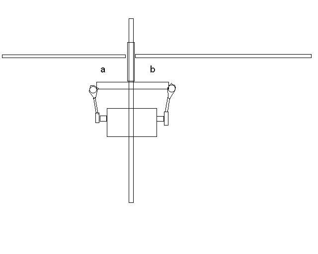

am new to the forum and a newbie pilot with a eflite blade cx2; have had great fun so far, with only a few blade cracks and minor repairs. however after my last crash, the heli wants to drift severely to the right just before take off; i have tried to trim as much as possible, checked for asymmetrical weighting, etc.. can't seem to figure out what to do.

Before you head back to the hobby store and ask about servos, you need to examine your swashplate and servos.
Here is what I would do.
CENTER YOUR TRIMS --- !!!! (did you catch the emphasis?)
1.) Disconnect the ball linkages from the swashplate. Power on the heli.
2.) Move the right stick in circles, and see if both servos travel equally.
3.) If they move equally, go to the next step, if not, you have a bad servo.
Centering your servos:
1.) Power on the heli, let it sync up (you might want to disconnect the motors for this just in case you bump the remote.)
2.) Unscrew one of the screws that holds the white servo horns onto the servo itself, remembering the orientation of the arm.
3.) Replace the servo arm onto the servo, parrallel to the ground, at the most level angle you can, sometimes a perfect 90 degree angle is not possible.
4.) Rescrew the arm onto the servo, and repeat for the other side.
Leveling your swashplate:
1.) Viewing your heli from the back, note the image attatched to this post.
2.) If side A is HIGHER than side B, screw the ball linkage on side A further down onto the control arm, etc, etc, and visa versa.
3.) If side A is LOWER than side B, screw the ball linkage on side A further away from the control arm, etc, etc, and visa versa.
Ideally, you want the swash plate to be completely level, that is the only way to get a proper hover without major control inputs.
Now, here is the relatively hard part.
You do not want to have one arm that is significantly longer or shorter than the other, which means in order to level the swash plate you will have to work with both sides. It is not terribly difficult, just requires some patience to get the swash level using both sides. Generally you will HAVE to move both sides to get it leveled.
After you have done these two things, your trims should work properly in flight, and your hover should be stable.
Let me know what you figure out.

It sounds like the swashplate seperated. If it did just squeeze it back together and you will be back to normal flying again.

I agree, swash plate separated.
After a minor crash, my CX went fast forward and a little right. I checked and everything looked fine. I noticed the swash looked "odd" when I was checking it for level. I squeezed it back together gently and success! Flying normally again.
Check that swash!
