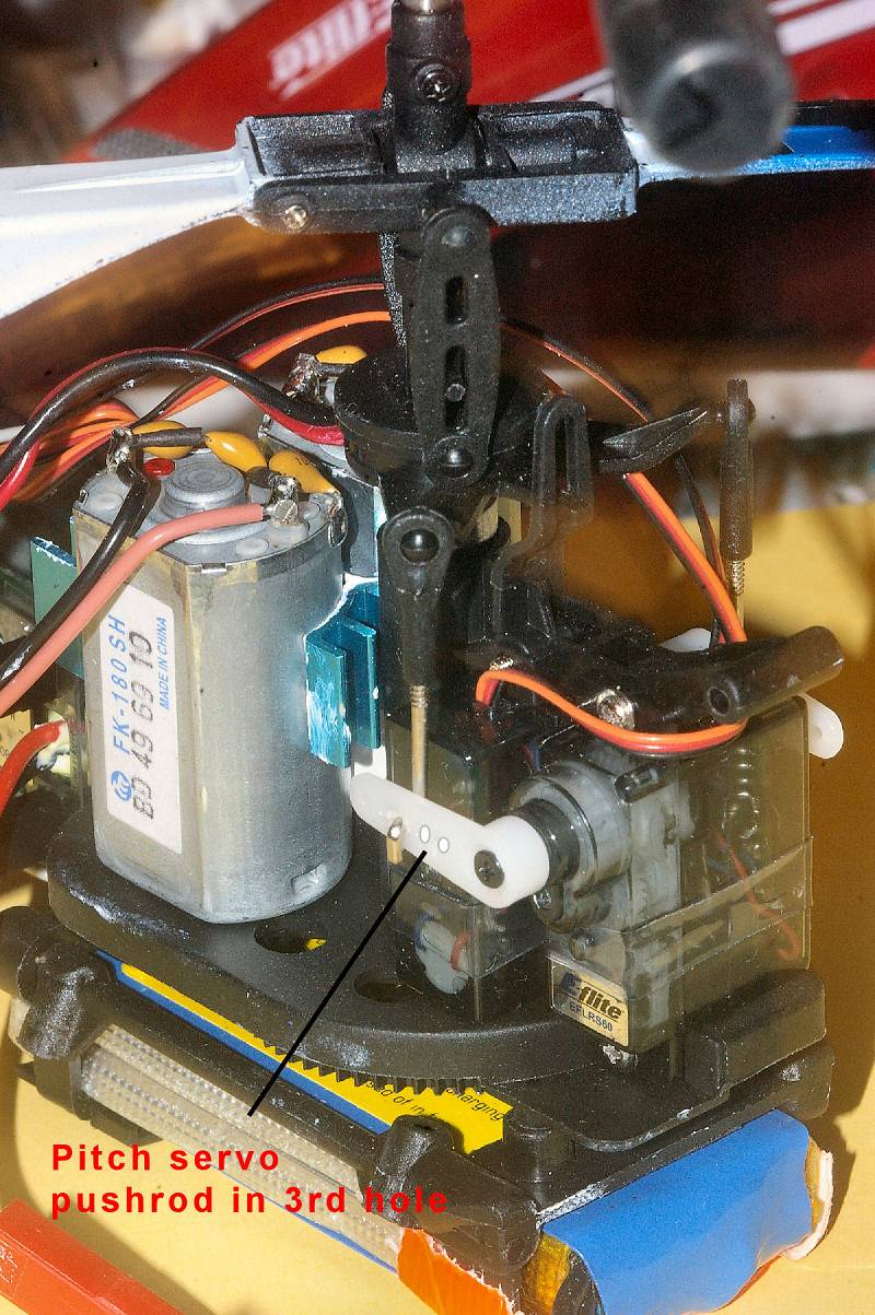

Hi gang
I heard that changing holes of the on something could make yourheli fly bettter and more controlable
[&:]Could you please help me because I'm a begginner and I didn,t understand this thing with the holes..
Thank you very much
Pap

Moving the rods for the swash plate out one hole on each servo horn which gives you alot better forward movement if you go anymore then that then you have more of a risk of blade clack

Not to mention you can only go out to the third hole before you hit the swashplate travel limit. Anyway I moved mine out one and it's great! Just be sure to remove the servo horn before trying to get the rod back in, because you'll need to widen the hole first.

But could you send pictures of it cause i'm not so sure where are those hloes

The holes..

Thank you sooo much but do you have blade clacks at the third hole ??
and if you have the Jamie CF tail boom , what are the ajustemets that you did on the heli ??
