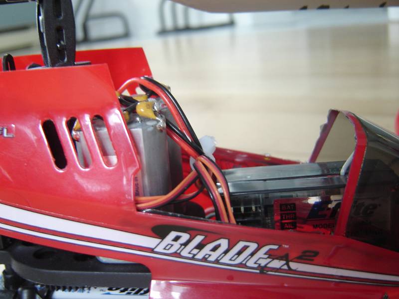

I also cutted my canopy it may not be beautiful , but it has advantages :
-motors are cooling fast
-don,t need to take out the canopy to play in the 4n1
-can touch your engine to see if they're hot

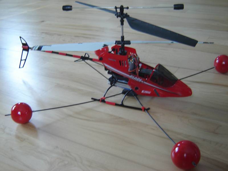

take a look at my heli !!

Remove those training balls[X(] The heli will respond better, BUT only after you feel comfortable with the handling
It won't take long to get the feel but it is great without the training gear
Go slow you will enjoy the product
