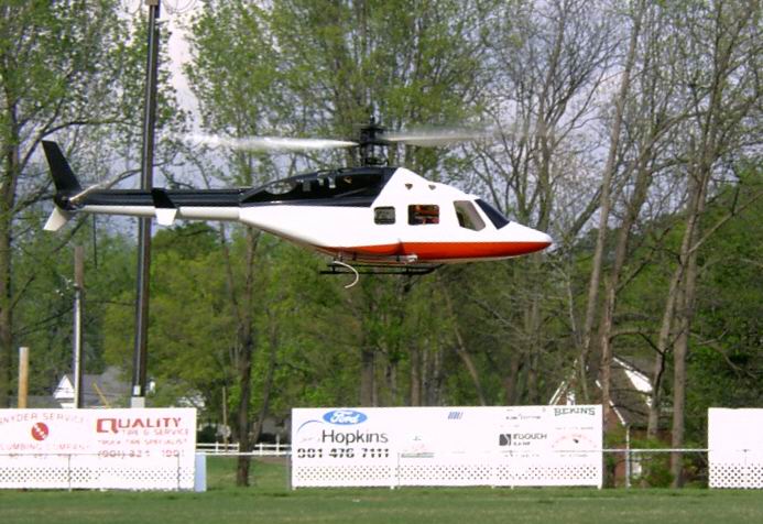

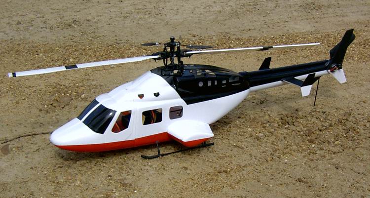

I will be out of town this week but when I return I will be introing a new Bell 222 and Airwolf for the micro cp helis. At the moment I dont have clear windshields but that wouldnt be a problem to make. Also I can form bodies out of clear Plastic. The side windows would only need flat stock clear plastic. I myself usually leave the side windows out for cooling. Heres a couple pics of the bodies. I fly all my bodies on a minimum stock setup. Having a brushless system is only a plus.

On a side note I may add, I usually fly all my scale helis idle up off(most of the time), flat main blades and I adjust pitch curves and throttle curves as needed (using computer radio). If Im using Stock radio I usually adjust the pitch links which I normally add in a few degrees of positive pitch to comphensate for the added weight of the fuselage. As far as batteries I suggest a good 3s 1000-1320 MAH 15-20C battery(ies)

Wow, I didn't know I would possibly need all kinds of mods for a scale fuseladge. Everything I have is stock, except the heli head and the tailrotor mod. Could I apply a Bell 222 body and not have to buy bigger batteries, brushless motor and all that good stuff? Also, if u formed me a clear 222 body, would I be able to mask the windows, so I could paint the body and leave the windows clear? I'm not sure if it matters, but I have a CP pro, not a CP.

Not really alot of mods needed on most bodies. As I said ive flown almost all mine in stock configuration and the only exception is those models that were elevated tail models which all I did was lengthened the tail motor wires and put the tail motor in the scale location. Yes, clear bodies can have the windows masked. It dosent matter about your heli being a Cpp
