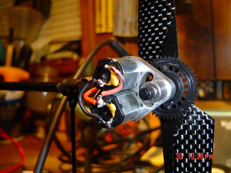

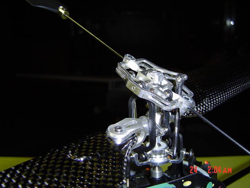

Hi Wilin, most say the plastic molded parts on the heli head just break during hovering flight, for no reason. I made roughly 50 flights with my CPP and never had a plastic part break. Below is a image of a aluminum head that I recommend, if u like your CPP enough and can fly it without crashing. I added the aluminum head cause, my heli has some 80 flights on it, without a single blade strike, much less a crash. The aluminum head has zero slack in it, heli fly's much better with it. If u add the HH gyro, u may wanna consider the twin tailmotor setup, image below. HH gyro will make those tail motors turn and burn. Most think the motors burn up, but I found most of the time, the motor bearing just gets out of place and doesn't allow the motor or motors to turn, I would do the smart thing and simply replace them. The main motor goes out after, roughly 25 to 35 flights. When the main motor goes out, I replace it along with the tail motors. I like to prevent crashes, not create them. The CPP, has broken many wallets, for numerous reasons. Treat your CPP and other heli's with total respect and you'll have a zero crash record like me.

Thanks for the response, can you tell me where you purchased the dual tail rotor motors? I have been reading some about it and it seems like a good idea. I am still at the hovering stage, I can hover tail in fine and move around my patio. I think I will practice some more with the sim before moving into forward flight and risking everything. I enjoy the CP, I think the heading lock gyro would make it a little more enjoyable though. Thanks again.

Here's the link to the twin tailmotor mod http://cgi.ebay.com/Blade-CP-CP-Pro-...QQcmdZViewItem
Here is a link to the aluminum heli head, if u consider it in the future http://cgi.ebay.com/Blade-CP-CP-Pro-...QQcmdZViewItem

Thank you for the links. I think I will definitely order the tail rotor mod immeadiately and maybe wait just a little bit on the aluminum head modification. The help is appreciated.
