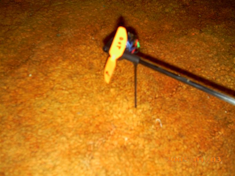

Well I got my first heli Friday and crash crash crash. In the last crash I lost my tail rotor, Rotor shaft, bearings, and drive gear.
Thats alot of parts to replace so I replaced the stock tail motor with a larger one and put a smaller prop directly on the motor shaft.
This made the tail hold a little better and the tail rotor is not so close to the ground plus its easier to fix when you do crash

Welcome to the balde DD (direct crive) world.
The only way to fly a bcpp imo.

Are there other things I can mod to add stability in hover?
Old 07-08-2007 | 10:09 PM
Joined: Dec 2005
Posts: 250
From: Charlotte, NC
Default RE: Blade CP PRO Tail mod
Super Skids make a great stabilizer. Adds quite a bit of weight, but they are very sturdy as opposed to the stock gear.
