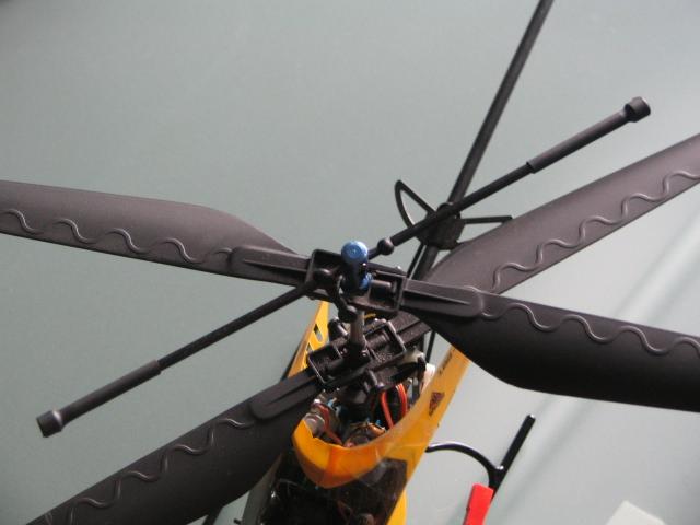

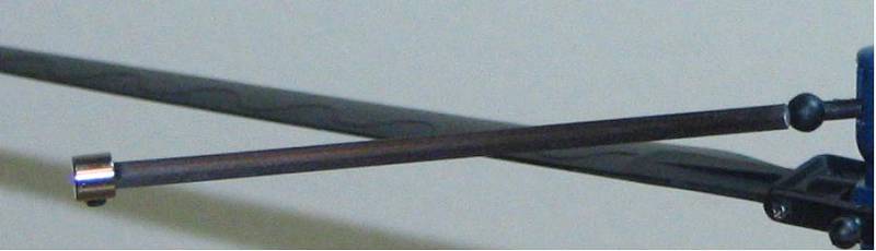

Does anyone have the links and pictures to complete this flybar mod that people all talk about doing to prevent blade clack?

I did find that guide there, but it sure would be nice to have some photos to go along with the instructions, I guess I was hoping to see photos.

I removed the stock weight and rubber cap and replaced them with 2 body grommets per side (the things that hold the body to the heli's chassis). I have not been able to make my blades clack after doing this even with hard outdoor flight and it's not to hard to control.

There arent (yet) any fabrication pics on the Soloboss flybar.
Only 'finished' ones:
[link]http://www.heli-max.net/mediawiki/index.php/HOWTO_Wiki_Overall_CX_and_CX2_Setup[/link]
I've attached them below, for your convenience .
Kamov has a picture of the collars he used, but i don't know if he'll let me place it here.
I don't want to steal anyones thunder .

I will take detailed photos and send them to sufflez so they can be posted. That would make a good first move toward completing the website.
Shufflez, I expect that a clear photo of 640 X 480 should be large enough to show excellent detail on a computer monitor. And the photos are easy to move (small file size).
