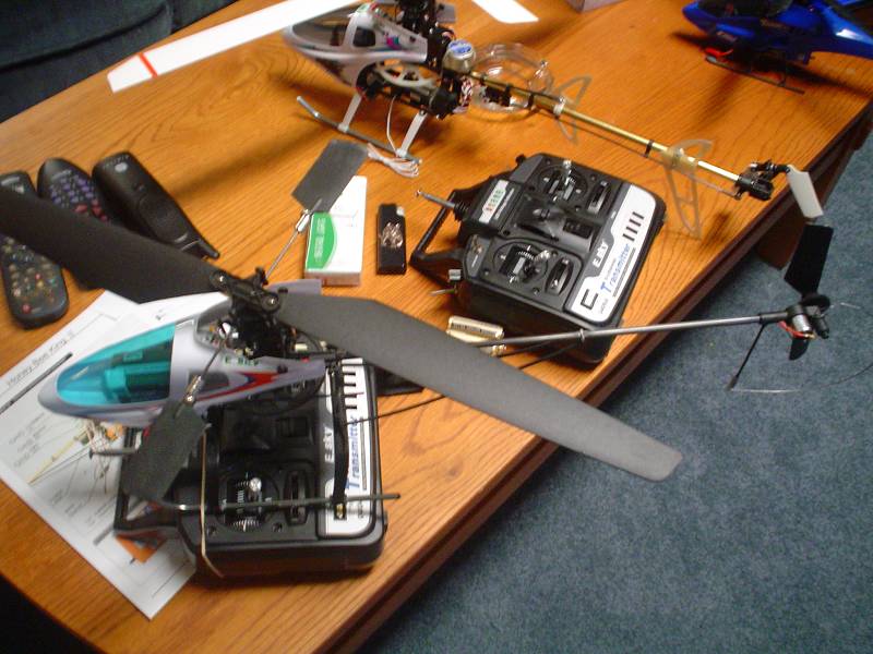

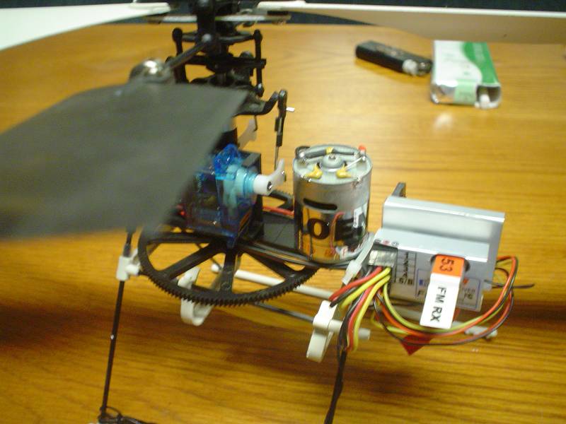

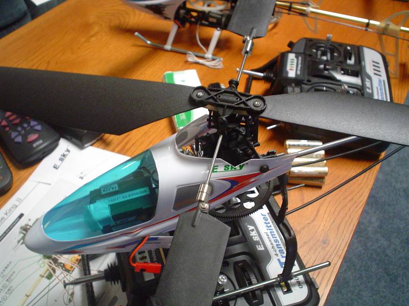

hey all,
the hbfp version 4 / falcon 40 / walkera4#4 is the best for learning! - they are all about the same - the hbfpv4 has a 2 inch longer tail than the walkera #4 (for better tail power/control), dunno about the falcon 40
follow my fp setup instructions (about 30 minutes) and you'll be holding the tail and hovering in no time - it is all about setup and trimming
1) - take it out of the box and start charging the lipo - while it is charging, start familiarizing yourself with the head - pull the ring-like linkages from the rotor head and remove the rotor head from the bird - check out the bearings - get the blades aligned, tighten them up slightly and check for balance using the same trick as the cx2 balls - make sure they can move in the rotor head just like the cx2 with grips (same concepts apply to both birds), check for mold flash, etc
2) check out the flybar - the paddles are actually little wings - they have to be exactly flat to the heli, and locate and familiarize yourself with the 'control frame' where the flybar shaft goes through - see how the swashplate links to the flybar control frame and thus twists the flybar, making the little flybar wings pitch up and down - this is the most important thing about the flybar, cause after your first crash the paddles will get skewed and the heli won't fly flat, just as if you had a bent flybar on the cx2
3) - put the rotor head with the blades back on - set it in place and use pliers to pop the bearings into the holes - when the lipo is ready, power up the transmitter and power up the bird - the green light is the same as on the cx2 - remove the linkages from the swashplate to the flybar - spin up slowly and check the tracking on the blades and flybar and get them perfect - this is your stability, just like on the cx2 and just as important - rehook the swashplate to flybar linkages (watch out for longer and shorter linkages on some variants - stick with the shorter ones for now), spin up and get the swash flat - this is like the swash on the cx2 and the heli reacts the same to a non-flat swashplate - adjust the servo linkages to get the swashplate flat with 0 trims on the tx
4) you may want to do some crashproof mods, like installing superskids (a bit heavy but totally worth it - leave off the fins, use the wire tailboom support, leave the battery hanger pins long and shove them forward to protect the 4-in-1, ca the joints to make it sturdy) - change out the carbon fiber flybar stick for a metal one, and add some collars for extra control - make a spring steel or plastic tail rotor protector
and enjoy! - you will crash a lot at first, but the little bird will take it in stride - just straighten everything out and keep on flying
note: the blades can be broken - don't sell off your old blades - when you lose your fp's tail rotor or break the little studs off or the whole tail gear and rotor vanishes mysteriously, the cp tail rotor will replace the fp tail rotor
edge

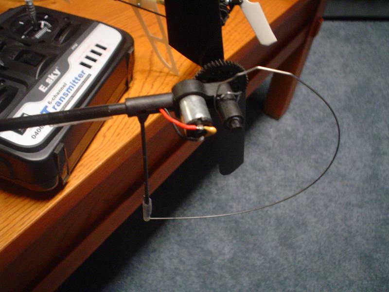

yes, those are scars from crashing on top of the rotor head - shows how much crap this little heli can take and keep on flying

Thanks for that detailed response. It does appear that I will be getting one of the three models you mentioned. I will be sure to follow your instructions when the package is in my hand!
michael at ushobbysupply carries the walkera4#4 ready to fly - order a set of superskids at the same time - cheap and effective, and he has the spares you will need
my hbk2 arrived today and i just ordered it saturday - thanks mr b!

i like the wire protector mod that you have...maybe i was just lucky not breaking the rear tail yet.. but the main rotors are quite sturdy

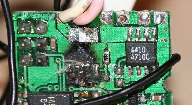

As BryFlyGuy67 and I have discovered, its not such an easy thing to just go brushless on the #4. If you loose the stock 4&1 to go seperates, you loose the gyro, mixer and tail esc. Those all have to be put back in to run a seperate rx. You can leave the stock 4&1 and go with a brush2less converter, BL esc and BL main. Brushless tail IMHO never worked for me and is even more expensive.
i understand the receiver problem - you could swap the walkera's 4-in-1 for a cp's 3-in-1 (might not work exactly right because of the cp's ccpm though) but that would let you use the other receiver - or you could just use the stock tx while learning then move up to a hbk2 arf
edge

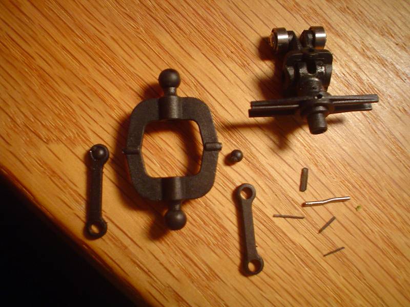

hey all - broke the balls off the flybar control frame on the rotor head on the esky hbfp this morning and the walkera version doesn't fit (too small) , been looking for a fix

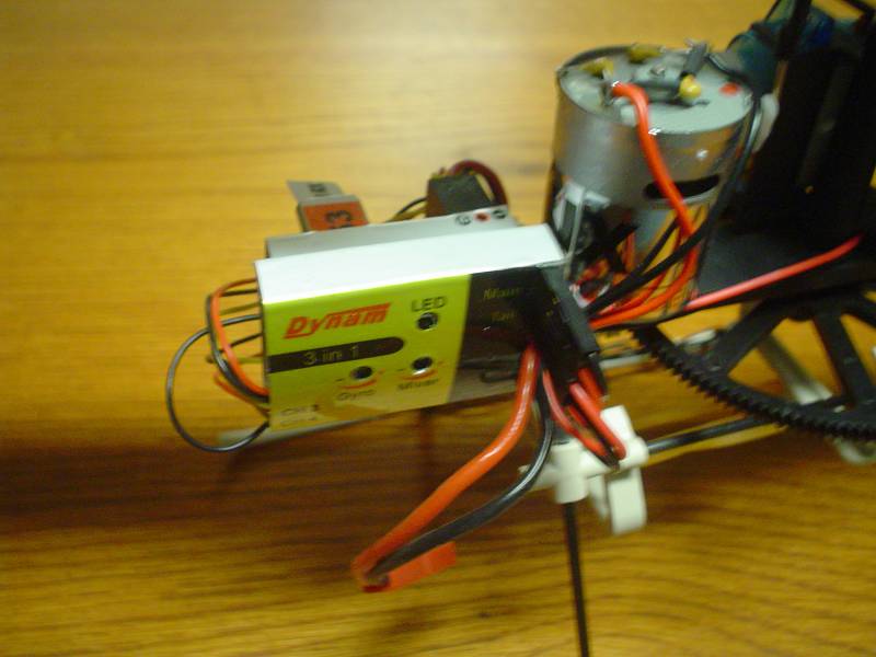

i just found out the dynam hughes 300 rotor head parts match the walkera 4's, and the skids, etc, are the same as the cp, although some parts are white - the white blades also are a match to the walkera's
and the radio in the dynam hughes 300 is a separate rx and 3-in-1 !!!!! - yippee - it will work with the dx6i or dx7 by changing out the receiver
so get the walkera 4, and a dynam 3-in-1 then start crashing!!!

no issue with the ccpm, because the ccpm is in the transmitter =) If you use a non-ccpm transmitter then you can use the 3 in 1 and/or the receiver from the blade and it will pretty much drop right in =)
yay - i've even got a spare cp+ 4-in-1 - what about the esc's, they got enough moxie to run a fp? - wouldn't want to ruin the 4-in-1 pushing those big ole heavy fp blades around at the cp's head speed
the dynam 3-in-1 is working ok right now, so i'm not going to nuke it yet for the cp 4-in-1, but if i smoke (or bust in a crash) this cheap dynam 3-in-1 i'll look at the cp's

should be good to go. If you take the FP's 4 in 1 apart and give me some part numbers I'll let you know for sure =) Look for an 8 pin dip package, off of memory it's something like a 4401 or something.

4410. Only one present on this board.

good info there =)
I was close on the part number but didn't quite get it. It looks like you're looking at either 10A or 11.1A w/heatsink for each chip depending on the mfg =)
so the cp series uses a 7413 which is rated at 9A each with a heatsink, and there are two of them on the main rotor channel, so you're looking at 18A w/heatsink, and something like 10 to 12 without =)
