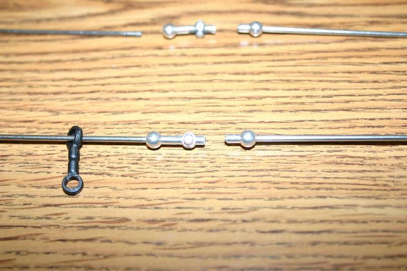

I don't mean "catastrophic" as in somethig really bad happened, but rather in the complete and total way that they failed.
Here is the scoop. I have been ruunning an LED flybar for some time on my newer CX2. It had the red paddles. Many of you have seem pix and video of this setup. A couple of weeks ago, I decided to get a new set with a blue LED instead of red and installed that on my older CX2.
On Monday, I was flying my older CX2, when I crashed. I broke off a main blade and busted the LED flybar. The thing that got me was that the failure point wasn't the flybar link. Rather it was the central hub of the flybar that rests inside the cap on the upper head. Strange place for it to fail, thought I.
So last nigt, I am flying my newer CX2, again with the LED flybar, and it takes a VERY soft landing on the couch. I go over to retrieve it and ***?!!? [:@] The flybar is broken is exacly the same place as the other one?
The way these both failed suggests fatigue fracture.
Anyhoo, I am now looking for a new way to mount my LED paddles. I have been reading a bit about some of you that have decided to create a flybar rod out of CF tube. Please tell me more about how you are doing this.
Here's a couple of pix of the damage.

That pretty much renders it useless. Fortunately You can buy Just the central aluminum hub. I think Michael's got them.
Anyway, alot of people here are simply taking a stock flybar, cutting the hook at the end off to shorten it to varying degrees; although if You have the grips, Mine seems to do just fine leaving it long as possible because I have the extended upper head, so don't worry about blade strikes.
Then slide good fitting c.f. tubing over the stock flybar, and adding weights, again, to varying degrees, and that keeps the c.f. tubing from sliding off.
Almost indestructable ! !
Even if it bends, it is not a compound bend, but a simple bend right at the end of the c.f. tubing and the hub; about the only place it CAN bend, and is easily straightened.
So, maybe You could rig up something like that with the paddles and You're set.

If the rods are steel, and the hub is aluminum; then I think the steel will win everytime in a wreck. I hope it's a fluke, my Friend.

Gary spelled out the cf modded flybar nicely. I would take it a step further and thread the ends of the stock flybar to accept the lighted tips. I'm thinking the tap to thread that small would be fairly inexpensive. Probably something you could pick up at Fastenal or any bolt supply house pretty cheap.
That way you will have the best of three worlds
, stock flybar with better hub, cf tubes to protect flybar, and lighted ends. Would be pretty cool. The aluminum hub on the lighted flybar will fail repeatedly. Wrong material for that application IMO! Not enough give in it too brittle when flexed.

PERFECT ! !
I need one anyway.
BTW; Horizon Hobby has the tubing; it's .125 outside diameter carbon fiber tube, and it available in 20" lengths to keep an odd box and shipping costs down.

I'm gonna try to carefull drill all the way through the aluminum center hub and run som solid c.f. rod the same diameter all the way through it, center it and epoxy it in. Then put the weights on the end of that; if too floppy, then will super glue a shorter piece of tight fitting c.f. tubing on the inner half or so, then screw in the weights backed up with ca. I think it might work. It will always be straight and will flex enough to hopefully eliminate the stress. I don't know about the light paddles of how it would work with that, but I'm always trying to eliminate steel wherever possible. I just want the weight on the ends, You know? Maybe I'll drop a Gram or two.
I'm gonna have Michael send me three hubs.

That sounds interesting. Let us know how that comes out. My own idea is a little simpler, I think. I need to find some hollow CF tube with an ID close to that of the stock flybar. Then, I will cut the hook end off of a stock flybar and slid ethe CF tube over it and affix with either CF or Gorilla Glue. This approach should make it easier to install, provide bending support and also be stronger due to the metal core.
Problem is that I went to my LHS yesterday and they don't have hollow CF tube.

Yea, I'm trying to get a light and unbendable solution; eliminate the steel altogether; and the aluminum hub is the only way I can do it; as the plastic one would be too hard to work with. The aluminum is already drilled out somewhat. I want something to flex in a wreck, and 'spring' right back into shape.
