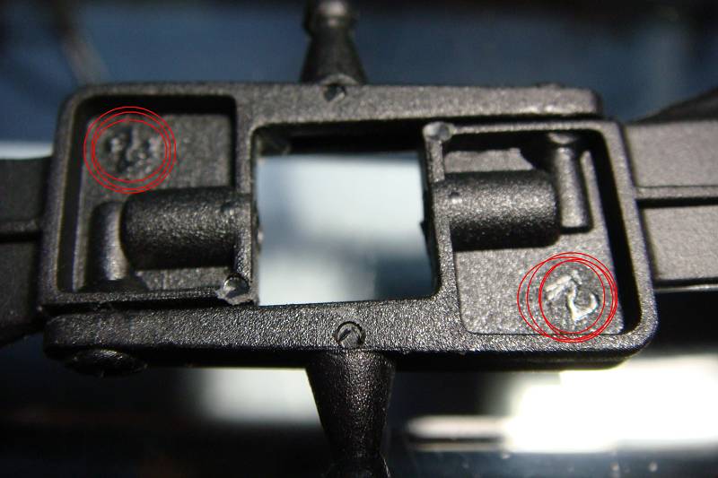

Check the scribed mold number on the blade near the hub (1,2,3,4,) if they don't match, neither will the weight of Your blades.
Try to get them out of the same bag, if not, You definately need to balance them. You won't believe how much one can weigh next to another one of a different mold. I've had it where My heli was almost unflyable just grabbing two out of a box of mixed.

As Goldslinger said, it helps to match up the #'s when buying and matching your blades. Here is a picture that shows where the blade #'s are.

That's just it, the molds are not all the same. I use to machine plastic injection molds for Preston Petty Products. PPP was the company that made all the plastic dirt-bike fenders, numberplates, etc. that everyone used back in the 70's.
Molds are finish polished by hand and individual mold cells can vary a few .000" from one to the next. That small amount can cause significant weight difference for something that requires the kind of precision needed for blades on these small helis. If you are a shooter and have reloading scales or some other scale that will measure very light weights then weigh some blades, you'll be surprised.
My experience with four different CX2's (family/friends) definitly indicates changing blades that are significantly different weights causes seriously different flight characteristics from what the prior blade step-up used. Think about that for a minute, if you don't have balanced blades when you first tune your CX2, how can you expect it to fly the same when you break blades and randomly select replacement blades. If you start with balanced blades, when you break one and replace with balanced blades your tune will hold, or at the worst be very very close requiring minimum re-tuning.
