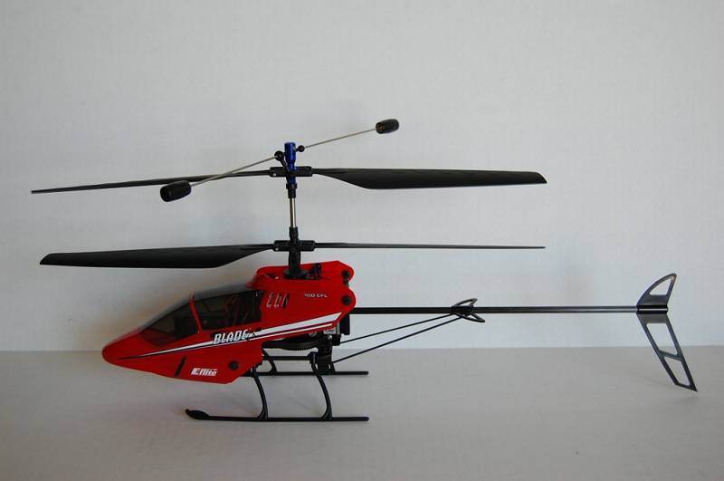

I'm not sure if mine is the same as his, but I have the BoomTownHobbies Model 3 Boom Kit.

The o-ring attaches from the mid of the carbon boom to the battery holder. I hope this helps out.

You got it ThAt GuY120... There is a mounting plate that attaches to the rear bar that is used to mount the canopy. The tail boom then mounts into the mounting plate. As you noted, the mounting plate (and attached boom) are "hinged" so that the rear of the boom can lift up. The O-Ring is used to keep the boom from lifting up. The nice part about this design, is that it provides "give" if you land hard on the boom and tail... it just lifts up rather than break. I have the BoomTown boom and have been very pleased with it!

the rubber band works perfect and I got about 50 for 99 cents it goes from the mid point of the boom where the mid wing is down around the battery holder so the boom does not lift into the prop during flight if anyone else has this prob I suggest buying a pack of assorted size rubber bands thanks guys
