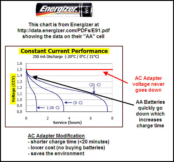

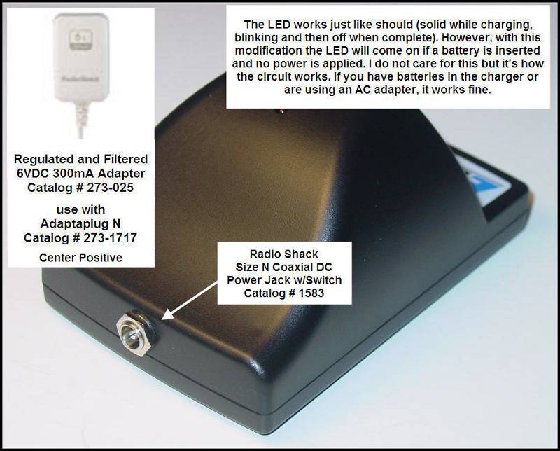

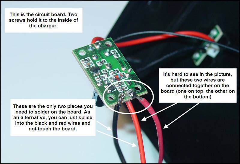

This modification will allow you to use either batteries or an AC adapter.
As an engineer I work with schematics, but I thought it may be easier for you to just lay out your charger as in the pictures, buy the parts from Radio Shack, and follow the instructions.
If you have questions, let me know. Mine is working great.

would a 150ohm resistor do the trick
Thankyou works great

does it matter which way the resistor gose on the wire? thank you
Old 11-20-2008 | 05:21 PM
Joined: Dec 2006
Posts: 178
From: Plano, TX
Default RE: mCX Charger Modification
resistor can go either way. Radio Shack does not have 180ohm. 150ohm is fine Catalog #: 271-1109

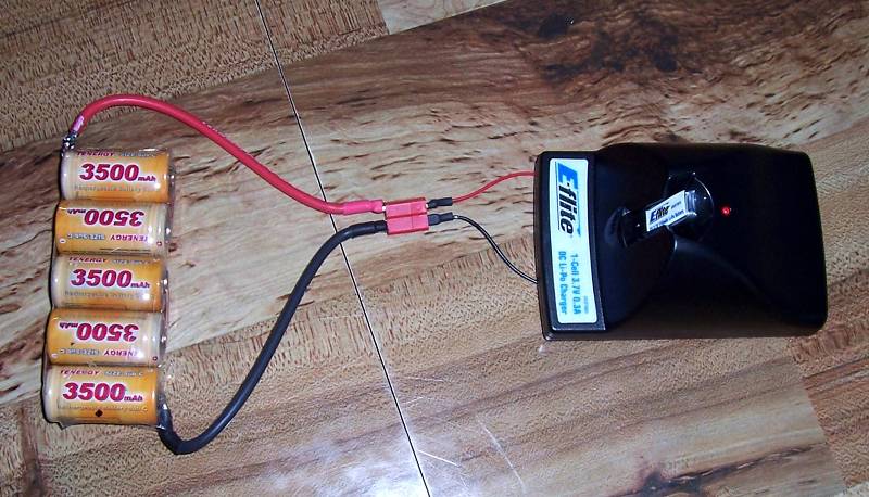

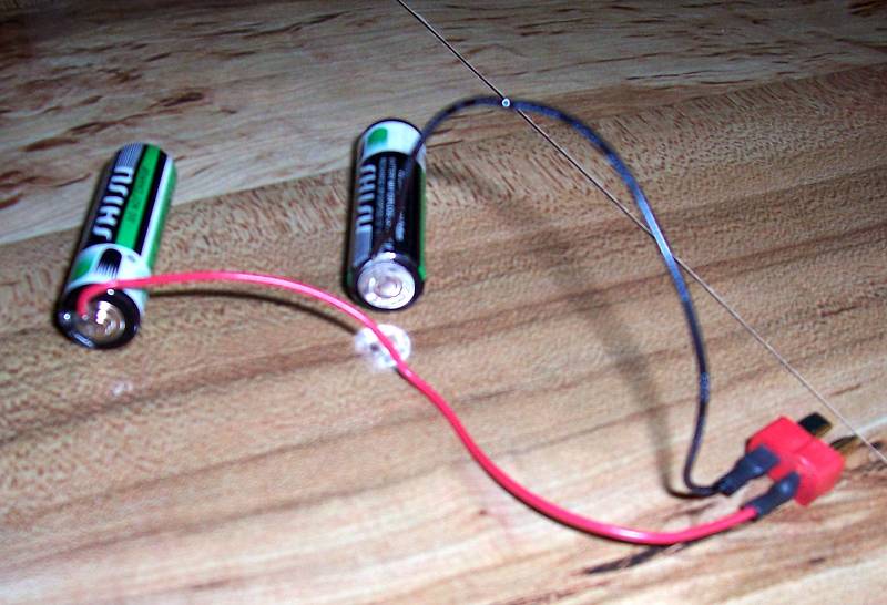

Using items I already have this is my set-up:

I like you did the conversion. But long ago converted my MCX stock charger with an old 300 mAh 6 volt power wall 120 step down power source I had sitting the drawer. And for the most part I re worked like GDAVIS

This may be a novice question but if my radio shack only has M connectors and I buy matching, will it work the same?

Hey I have a 200mA 6VDC wall adapter.
what resister should be used

Thanks a bunch for your mod, works great, halves the charge time also a plus that it is still battery usable.
