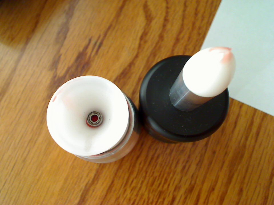

Thank you both for your replies. However, the problem is now fixed. I took one of the old bearings down to the LHS and when the 'mechanic' looked at it, his first reaction was that the bearing is full of oily dirt. What I did about a month ago was put a drop of 3 in 1 oil into each bearing...big mistake. When dirt got into the bearing it couldn't fall out again because it adhered to the oil and eventually 'chewed' the insides to bits. Okay, that's being a little melodramatic, but it did ruin them. So, to make a long story short, he graciously sold me a new set of bearings, I installed them and now the Old Bird is singing happily again!! Not me, the helicopter Again, thank-you for the replies, it was much appreicated!!!

I would have never believed that if you had not written it. I dont use oil on my bearings, I use grease! I bought a Rc device called...."the greaser" and it is made for RC toys and will force grease in any bearings. I have greased all of the my helis and my plane motor bearings as well. If the grease collects dirt it will stay on the outside.

Hey JPEE, yes let us all know where you got that bearing grease packer. It's a typical device used in automotive applications so I guess I shouldn't be surprised if someone made one for tiny bearings. To me it sounds like something clubs should own for their members.

This first link tells you all about it. The second link it to Petes website and it on the left top side of the front page.
