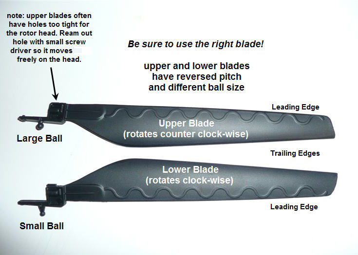

Make sure it's the right blade
First be sure you are two lower or two upper blades. They rotate in opposite directions yet still have upwards thrust , so the leading and trailing edges are reversed. If you get them mixed up on your bench, the blades with the larger balls are the upper blades, the smaller balls are the lower blades.

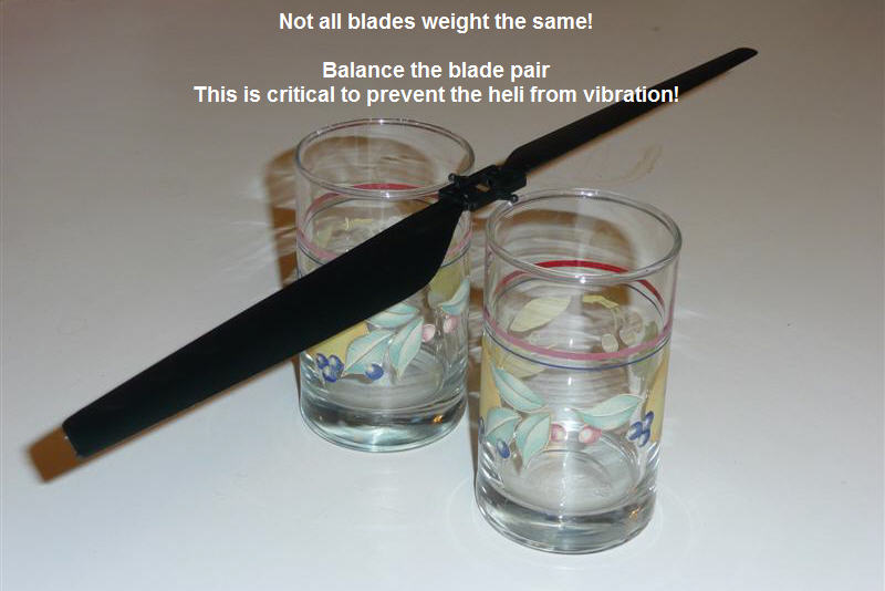

Check the weight
Pairing blades of unequal weight will cause vibration of the rotor shaft. This is obvious at lower throttle positions when the heli is on the table, as the shaft and body will shake. In the air, the tail will vibrate. To avoid this, be sure your blades are balanced. Snap two blades together and balance them on their balls with two cups. They should balance pretty close to horizontal. Keep the heavy and light blades in different bags for easier selection next time. Mark them with an "H" and "L".

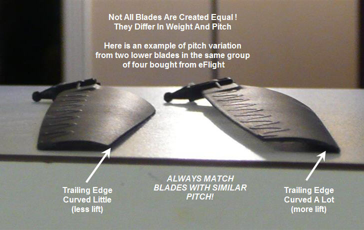

Check the pitch
Pairing blades of unequal pitch causes all sorts of issues. I have experienced TBE (toilet bowl effect), vibration, and even not being able to develop enough thrust to take off! The flatter the blade the less lift it has. Blades with more pitch have more lift. Place the blade on a table, with the tip pointing towards you. Look at the trailing edge. It's obvious that some blades have more pitch. Match blades with the same pitch, and the ones that are almost flat I discard, you simply need the curvature to develop thrust!
