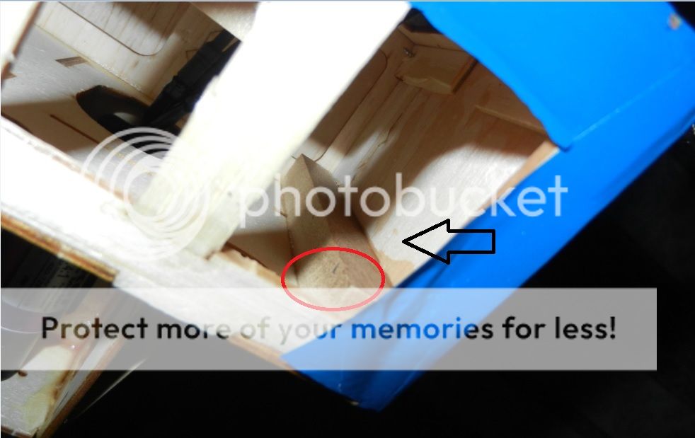

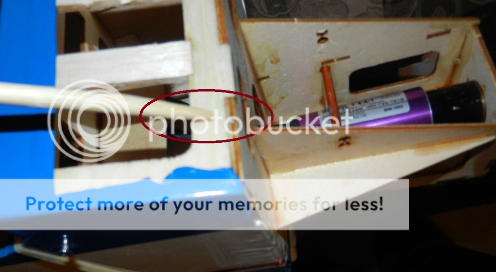

More house keeping (10-16-2013):
Okay guys,
Last night, I dedicated a few hours to look over the Model very carefully and took advise of my Good Buddy (Sky Bro), Gerry (simano) who advised me that the Firewall and motor mount to Firewall bounds.
Well, I did see very good glue between the Motor Mount -to- Firewall, however, I found at least two areas where the FIREWALL was beginning to come apart from the model itself! This was perhaps my hard landing during my very first Flight as the model did land hard and broke propeller.
Took out the LARGE STICK (Hardwood) and went to town and re-enforced the FIREWALL as shown in the following pictures and re-applied Glue to those mating surfaces from FIREWALL -to- MODEL structure.
Motor Brace!
The other Side!!

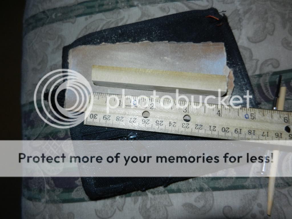

More work on my SA CAP 232 (10-17-2013)
Well guys,
Did lots of work last night again on my Steven's Aero 40A Cap232 and installed some hard wood side Popsicle formers along the inside of the bottom FUSE where the wing mates with the FUSE. I noticed the side wood is "Balsa" and there has been at least two occurrences that the wood has split or crack.
The Airframe is super light and I just don't understand how could the cross bracing between the Formers (FUSE) are done with a rectangular balsa wood without any interlocking, they are just glued in a slot of sorts and at least two of them has detached.
I did not take any pictures as of yet on the latest re-enforcement on the FUSE, however, I still need to install some corner gussets to really give the entire structure a stronger and sound airframe. I don't how this Airframe has survived this amount of time and flown for countless flights without any structure failure. To me at least, it seems to need a little more re-enforcements in critical areas.
