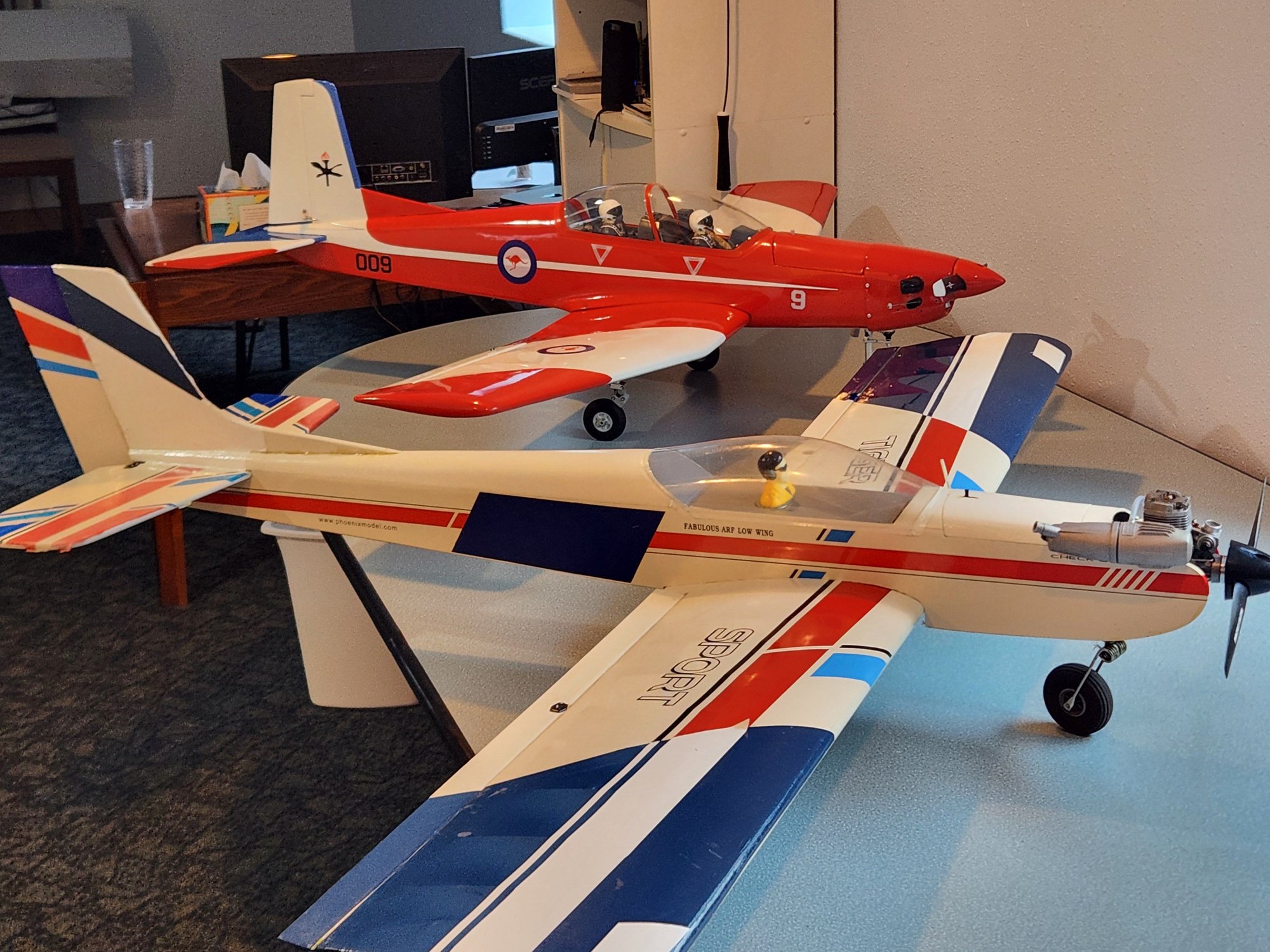

Got the airplane sitting on its gear today and it looks sharp.
>>>Aluminum wing tube was 1/8 inch too long and the wings would not completely mate. Cut off a bit and all is good.
Many builders complain about the cowling alignment, but they likely do not realize that the engine mount holes are off center to allow right-thrust to be built in. The Left Engine Mount needs to be shimmed with washers. Once that is done, the prop shaft of the engine is right in the middle of the front cowling hole. Forget the right thrust, and you will fight the cowling forever! Photo below shows the washers used.
The cowling does need to be trimmed for the retract servo mount and also around the engine carburetor. A large hole is needed at the bottom of the cowling to access the glow plug as well.
Slowly working up the PC-9 and it sure is one sexy looking bird! The cowling was one of the easiest fits I have experienced so very surprised with all the negative reviews on that point. Certainly not for beginners but lots of building fun for around 200 dollars US! Working on control linkages and tail mounting next,
Got delayed a bit trying to find a servo that fits the nose wheel steering mount. The recommended servo is about 80 USD and I've never paid that much for any servo! Found a Hobby Park metal gear waterproof servo (HD0712HD) for 20 USD that is working great but did have to make an adapter plate out of Lexan for it. Next thing is to set up the throws exactly like my ragged 9 year old Tiger and then do a few taxis tests before flying it.
Everything is done and will run the engine tomorrow after a night's battery charge. First flight soon but I always do taxi testing first to see if anything shakes loose. Been a super fun build!
