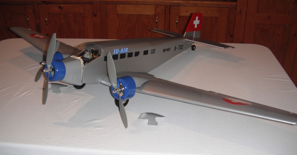

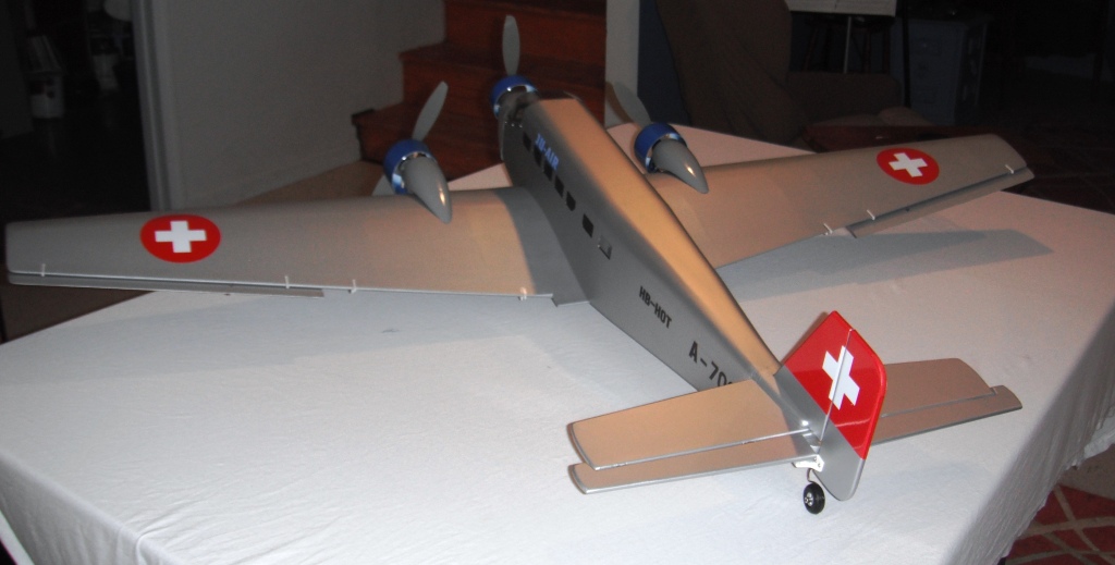

Here are some pictures of the Ju52. The cowls and nacelles need to be finalized as well as the flaps. Also will have to go to a smaller prop and larger tires.

All finished. Now all we need is some decent weather.
