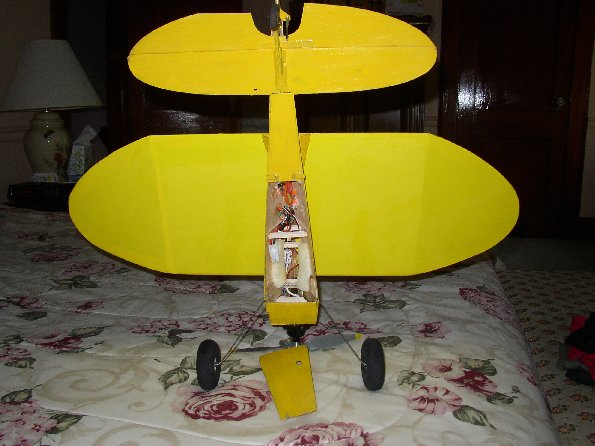

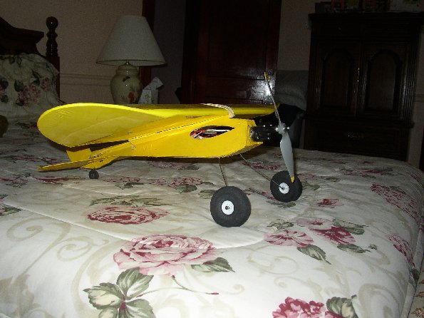

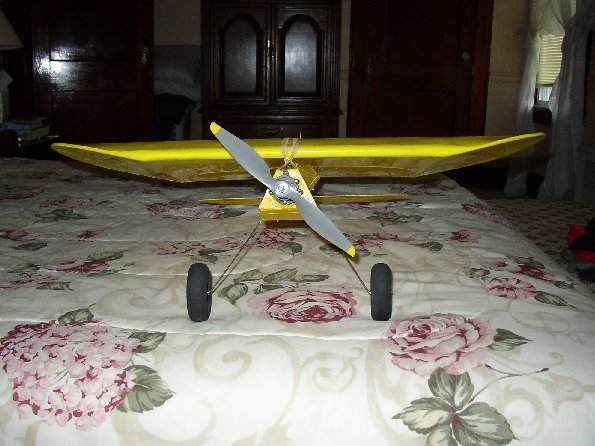

I would say you are pretty much on track. With a flat bottom wing, you will get lift for sure. Maybe you could leave the motor also at 0 degrees for the first flight or so, while in flight....look for the usual tendancies like "ballooning" or lift up only when you apply throttle. If this happens, then I would start adding down thrust. Also look for the model vearing to left when applying throttle.....if this occurs.....add right thrust. Usually the corser pitch prop used, the more right thrust you will need. With no ailerons....right thrust is advisable. I have an elelctric Lazy Bee that has a very exagerated right thrust, but I am using a huge prop with a corse pitch. It makes a big difference.
