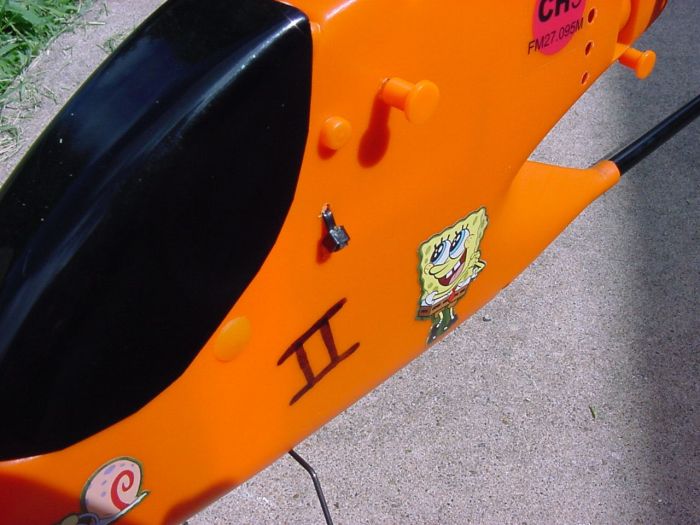

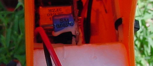

Here are some pics
Just cut a hole on the fuse where there is the hole on the board braces. Drill another hole above that and just zip tie it together. You can put on in on the back too. Only do it on that one side because the components are in the way on the other.
-John
-John
