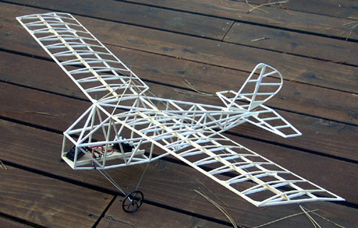

I've posted this before, but here is the bare bones of my latest. 1/8 scale ultralight with working flying wires and a full flying stab... I would think that qualifies as unique!
I like um small and light, must be the years I spent twisting rubber bands. I think we are a dying breed though as ARFs are getting cheaper and better built it is hard to convince a newcomer to spend the time that it takes to scratch.
Of course there is the "Unique" aspect.

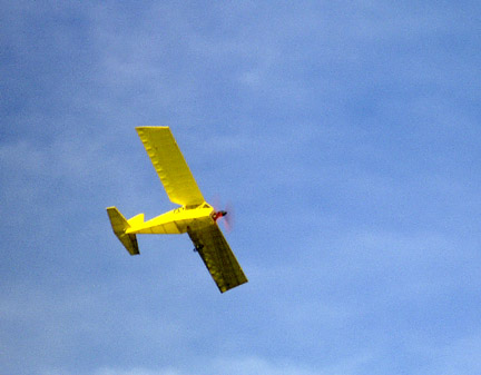

Q
Thank you for the interest in my project.
She's done and has about 8 flights in. I blew up a copy of a plan from an old Model Builder of a '70s ultralite called the Desert Duster. I kept true to the plan except found that I needed to add a center spar to strengthen the wing.
It came in at 36" wing span and 7oz RTF. I'm using a GWS IPS-2 that swings a 8x4.3 prop. Power comes from a 300-mah NiMh pack. I forgot to add that she also has pull-pull controls to the rudder and FS.
She was a challenge to build and balance (still working on that) but flies great. Take off is straight (into the wind) and climbout is steeper than my Slow Stick. The battery gives 15 minutes on a fresh charge.
Here is a pix of her in flight.

I remember seeing this picture in another forum, and was wondering if it was yours. Nice!
-Q.

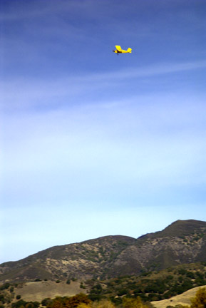

And closer in...
And closer in...
I must admit that my building skill is still no where near what I'd like it to be, but every plane that I build seems better than the last. You just got to keep at it. I generally use way too much epoxy, but I must admit that my planes need it. I'm a heavy lander. I always find myself running out of runway (or park) and then a wild 90 degree bank is involved (at 20 feet) to bring the plane around for a landing. I did this today (with full flaps) and ended up hitting the field at a negative 10 degree angle.
The plane is 100%, but for some bent landing gear.

Paul,
I love it so much, that I found myself buying plans, but for now, I'm sticking with the easy one's.
