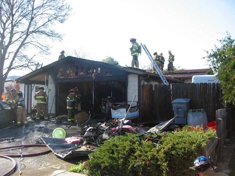

wow didn't know they could do that much damage. I think I'll charge them in the barn instead then
. With the Eflite Celectra charger do you have to hook it up to a 12v power suply? how does it get its power, or can you hook it into a wall socket.
The barn is more of an equipment shed with concrete floors so that would be an Ideal place to charge lipo's. If any one else has chargers they like for under 50$ please respond.

Yes, lipos can be very dangerous...but so can nimhs and nicads if they are abused as well. Make sure your ESC has the proper cutoff voltage set for a lipo (Lipos don't like being overdrained). Make sure your charger is set to the proper number of cells and never go over 1C (1X2000ma=2 amps on a 2000ma pack). Charge the pack on a cement floor in the open where it can't throw a spark onto something. Don't dent or cut the pack. If the pack shows signs of bloating get rid of it right away. Always remove the lipo from the plane when not in use (the RX/speed control can continue to drain the battery down even if the motor isn't on). If you get your plane stuck in a tree make every effort to retrieve it as soon as possible or the lipo will be drained beyond repair. When not in use store your lipos in a fire box or in an open area on cement. Make every attempt to keep the battery leads from shorting, using heat shrink tubing and electrical tape for insurance.
That all being said, I've seen nimhs catch on fire, overheat, etc....due to overcharging or shorting the pack. Heck, even a D cell battery can cause a fire in your house if it's shorted. I won't be going back to nimhs for most of my planes. The flight times and power a lipo produces will spoil you for life. These batteries, along with brushless motors, are sounding the death bell for gas in my view.
