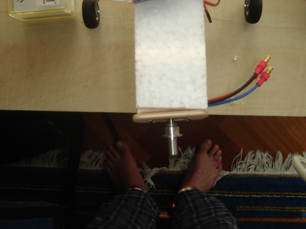

How is this? (with this setup, the firewall is perfectly lined up iwth the plane, but isnt it a bit much?)

never mind, fixed the problem. i glued the firewall in the wrong way so it looked like what you have just seen. thanks!
