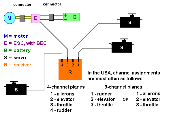

1) To keep it simple a basic wiring diagram for brushless and good quality ESC

It is simpler than you think.
1) To first order, an ESC simply replaces the throttle servo, so you plug the ESC connector (same as a servo connector) into the throttle channel.
2) Most ESC come with BEC =Battery Eliminator Circuitry. What this means is that the battery for the motor is lowered in voltage to supply the receiver and servos. Most if not all ESC also have a "LVC" =Low Voltage Cutoff", where if the motor battery reaches a defined low value (meaning it is close to being completely discharged in terms of supplying the motor), it turns off the power to the motor. However it keeps supplying power to the receiver and servos. Usually by throttling back to zero, you can re-enable the throttle power in order to limp back to the field. However you shouldn't overdo this, since LVC will be crossed again.
3) The ESC has two wires that plug into the battery. You will need to choose the variety. Personally I use Dean's Ultra for all my e-planes, although I could get away with a smaller connector for less than 10Amp applications. You will need to size the battery to the application.
4) If you are running a brushed motor, you will need a brushed ESC. It will then have two wires that run to the motor wires. You will need to add connectors here too.
5) If you are running a brushless motor ("modern" technology), you will need to use a Brushless ESC. It will have 3 wires going to the 3 wires of the motor. How you hook up the 3 wires doesn't matter. If the motor runs backward, simply switch any two of the 3 wires and it will run the other way.
In both 4&5, you will probably need to add connectors again! I use 3.5mm bullet connectors.
So no diagrams, but I hope this helps.

If I understand this correctly, there would be no connection going into the battery connection of the Hitec Micro 555? The receiver is powered through the ESC throttle connection?

And when using a BEC, you may not even plug in a receiver battery. All the plusses and minusses (including those of the BAT connector) are internally connected. Say the BEC gives you 5.0V and the battery gives 4.8V, you'd have a voltage diffence of 0.2V and no resistance. Not good, you can't have two captains on one ship, recipe for disaster.

Thank you Jeff!! The Holy Grail of wiring diagrams that eluded me in over 90 minutes of searching the internet. This wiring diagram should be on the first page of every electric faq. But then if it was I wouldn't have stumbled into this forum and learned more than when I started...
As for function/stick assignments, use the same assignement as your club or your instructor. Otherwise he (she?) cannot help you trim the airplane and do the take-off and landing, the most dangerous phases, for you.
