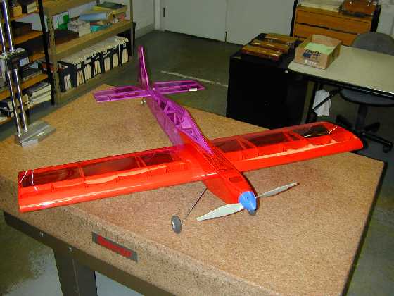

Well after a month of work here and there my E3D is almost done
Having to work for a living really gets in the way of playing with planes
As it sits here I should have it going this weekend.
The Bare airframe covered/hinged no radio gear or landing gear
weighs 14.7oz. I'm pretty happy with that as the average ones are around 16oz at that stage.
I'm going to be using a Hacker C40 12T brushless and 10 cp2400's.
I did some things a little different, using a pull-pull on rudder
and moving the elev servo into a better linkage position.

Its all assembled and ready to go. With a 10 cell CP2400 pack
it weighs 53.2oz. Everything is great, with the only possible exception being the Great Planes gearbox. It sure is loud and I am not impressed with the runout of the main gear.
Perhaps I am being overly critical and it will hold up fine.
If the weather holds on the "wet coast" here I will fly it this weekend. That and three other projects I must get done this weekend. All work and no play........ :spinnyeye
