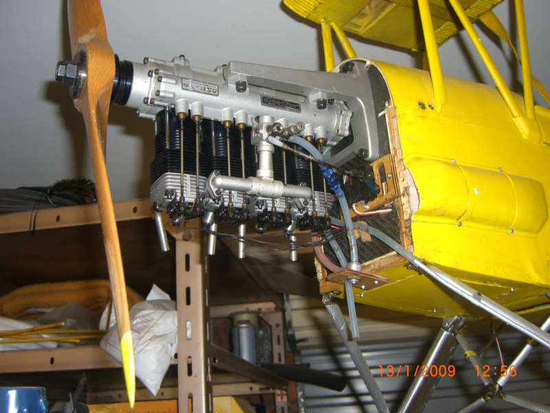

Hi,
I have seen those V8's They were made by Conelly. Unfortunatly they wont sound like a 12 cylinder Rolls Royce Merlin. A Merlin at full throttle does only about 2800-3000 rpm. No model engine will produce enough power st those revs.
I have an OS 50cc 4 Cylinder in line four stroke and it will just fly my 1/4 scale Tiger Moth at 3500 rpm. It still sounds too fast/
Regards

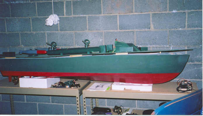

Are you really serious about A Aussie Spitfire with a Rolls in it ? Do you have about 500 to 1,000 for a 12 cylinder engine ?
If yes, I will post what will get the job done. Piece of cake.
I have done a 2500 to 3000 rpm V 12 engine.
Electronically. 120 watt amplifier, 6 LARGE auto speakers. Synchronized the increase in rpm with a increase in volume. Both peak together. Ear plugs are mandatory in a basement runup. It is a sound track from a British Vosper MTB. Did the WW II Vospers use the Merlin you need to hear ?
Rich

No I don't have a real V12 engine, But i do have a real 4 cylinder inline engine (50cc). it sound very realistic at 2500-3000 rpm but as I said it will just fly the model at that speed.

I thought the Merlin sound was the sticking point.
At 100' away my engine sound on water is fair. If you raised the boat 100' up, I know the sound would be much weaker due to the " scattering of the sound waves." I really think you need to build a true V 12 engine using about .50 nitro engines mounted on a beam with a central timing gear shaft. Each engine is fitted with a gear to the shaft.
IT will have the right effect with out any other stuff. It will also have plenty of VOLUME.
