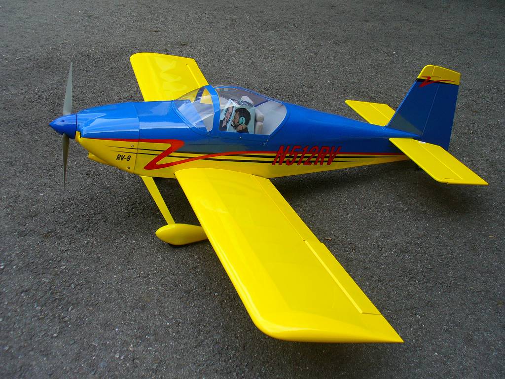

I was able to spend a few hours with the kit this weekend and made some more progress. I found the flap servo assembly rather frustrating as it took a lot off fiddling to get the two flaps adjusted to line up and the servo has to work pretty hard to hold them in the full up position. I've tried to eliminate as much binding as I can, but the servo really "buzzes" under the strain and reverberates inside the wing. I actually tried a several different servos with the same result. My tail section needed some slight twists removed with a heat gun. I have to finish up the cockpit hatch and install the rest of my radio/electronic grear and it will ready to test fly.
Jaybird

Found pictures of the full size homebuilt with this paint scheme, although it's a tricyle gear and the same scheme in white and yellow in the conventional gear. They look pretty cool!
Jaybird

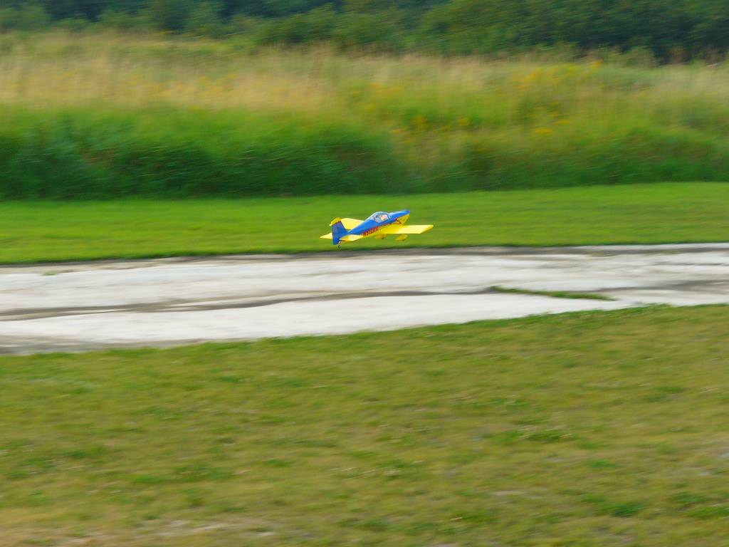

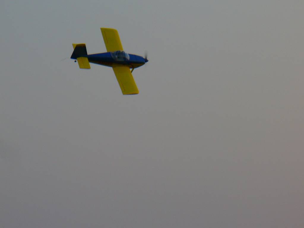

Maidened mine this morning with a quick flight on the way to work. The 450 pulled it up with no problem and it cruised around at 1/2 to 3/4 throttle while I trimmed it out. It needed up and right aileron trim for level flight. It is pitch sensitive being so short and having a large elevator. Some expo and more flight time will have that taken care of. I need to relocate my receiver wire (I know "old school") as there was some signal interference with it inside the fuselage. Landing was nice with the flaps, but it did bounce when I touched down.
This will be fun!
