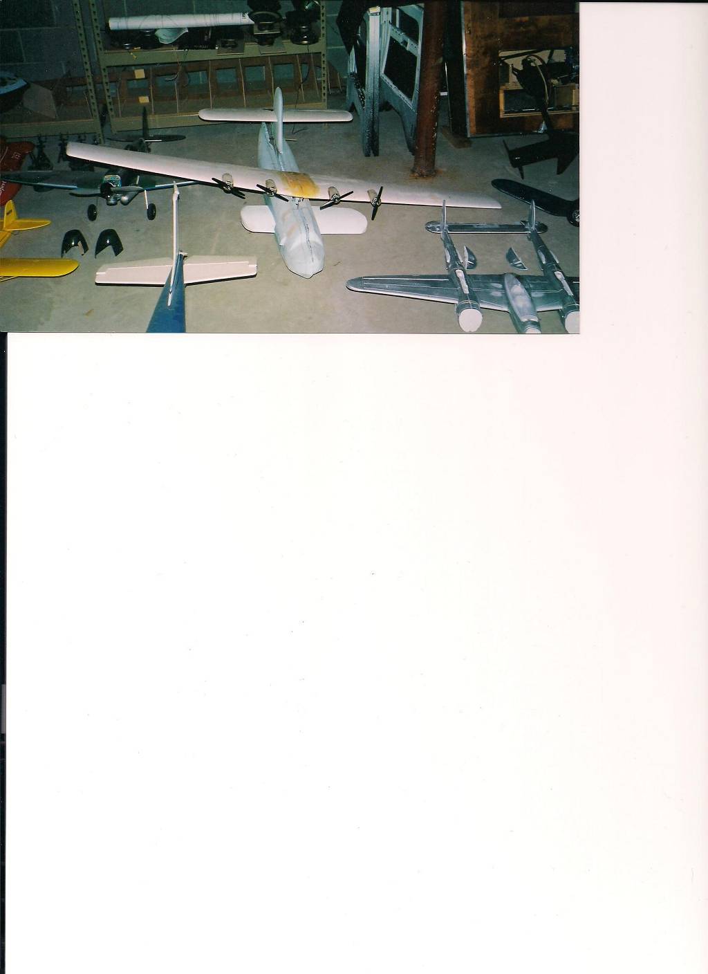

There is a company that sells the B-24 in a nice looking foam. You might want to go to a place called ?? www.wowplanes.com ??
It will give you a lot of known power parts needed for a plane their size. It will help you on the cost of a BIG 4 engine.
Below is my first scratch foam 4 engine. 60 " wing span.
Dave
