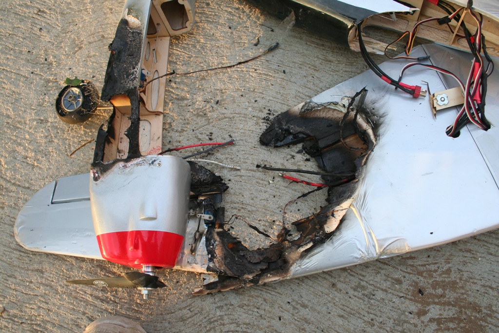

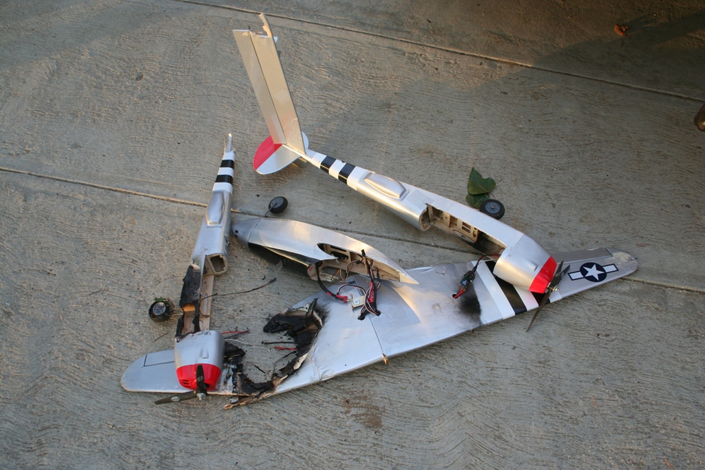

My Bro-in-law had the same plane and outfitted it with HiMaxx 2816-1220 outrunners, 8X6 3 bladed counter rotating props on a single 3s Lipo 3000 to 4000mah I don't remember exactly & TB 36 ESCs. She flew very well and had plenty of power well over scale flying. Not unlimited vert. On about her 5th flight one of the ESCs malfunctioned, and caught fire in flight. She crashed and burned, literally!!

hey rick, im sry about your brother in laws plane. Im looking at the pics and it seems like it was starting to burn on the other nacelle also... maybe that 3 blade prop was pulling way more amps then he thought it was....not enough safety margin on his esc? The eflite 480's are a little pricey.....i can take the scorpion 35a esc from my trojan and buy a second one....trying to get the best bang for the buck for around $100.00....this plane seems to be an "inbetweener"....needs something between a 480 and the next range of electric motors... I havent really weighed it yet as its not really put together....some have said it is every bit 4lbs and some say about 3.5.....2 motors with a combined 500w should be about right...ill probably need to look at all the specs for watts and amps for each one considered...the right size esc's and batteries in that order.Some people live by the 20% rule also....they plan system around performance difference of actual and stated by manufacturers which the general consensus seems to put it in the 20% range on average. This coming from lots of people with many years of flying and building....might be looking closer to $135.00-$150.00 before im done!

Yea, we also saw that. The amps pulled, using a watt meter, were well within the ESCs ability. I don't remember the exact numbers, but checking amp draw is ALWAYS part of the build and a good margin of safety is built in. As a plus to Castle Creations, they warrenteed both ESCs with new ones. The only thing we could figure with the 2nd ESC starting to burn was a major malfunction upon impact or some big voltage spikes when the first one fried. Without rudders, she's pretty much uncontrollable when one motor shuts down. If I were to build one, I'd disable the BECs and run a seperate UBEC to power up the Rx & servos. This was not the case with this model, although 4 small servos on 3s shouldn't have been a problem. I've gone to using UBECs on everything. Good luck.

RickAvery, if you had an RX pack in that P-38 you could have brought it safely home, assuming sufficient altitude for a dead stick landing.
