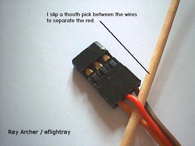

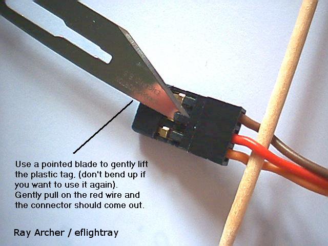

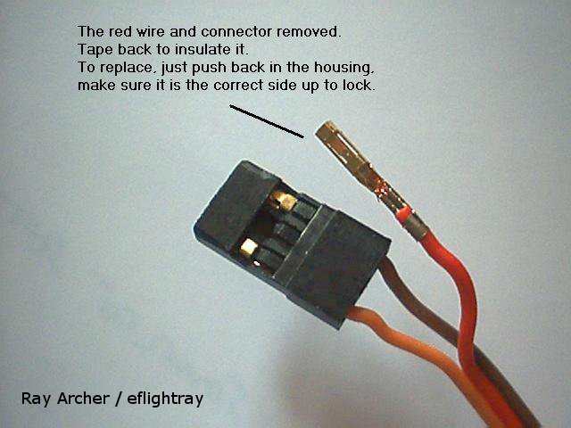

ron_van_sommeren 06-18-2019 01:12 PM
3 Attachment(s)
Originally Posted by pimpmycnc (Post 12531830)
Yes that works. You can think about using only one bec wire and pull the red line of the other escs out.
But not when they are optocoupler ESCs, otherwise the optocoupler LED does not get power. No pulse/information from receiver to controller.
I'm not referring to the HobbyKrap opto nonsense/lies, where opto means no-BEC. (I call a car without a steering wheel diesel. Very obvious, right?).
Vriendelijke groeten http://www.rcuniverse.com/forum/atta...1&d=1560891862 Ron
• Without a watt-meter you are in the dark ... until something starts to glow •
e-flight calculatorswatt-metersdiy motor tips&tricksCumulus MFC
Do not cut the red wire, you may need it again in another plane.
Attachment 2264673 Attachment 2264674 Attachment 2264675
