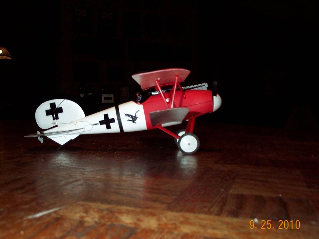

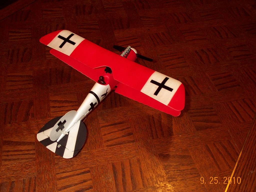

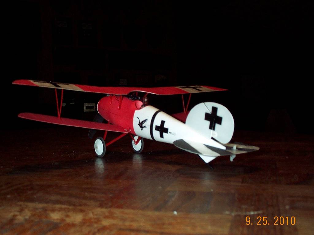

With pictures this time.
Pictures are from after repair so no quite as nice.
There was no hope for the servo. After working with it and swapping out servo motor and checking and tweeking the wipers it was finaly determined that the board had a problem. Apparently something burned out from the load of the hung up servo while looking for cause.
Never had battery connected over 10 seconds during checks.
Ok Robbed the Parkzone Cessna from one of my scratch builds and proceeded to install it in the Albatross.
This thing flies so nice that I am determined to fly it tomorrow AM.
Both push rods had to be located in same exit hole and for the less travel of the PZ servo the PZ control horn had to be installed also.
Once it was all back together and bench tested I relized how noisy and jerky the PZ stuff is.
The Flyzone radio servos are silent and smooth.
CONGRATULATIONS FLYZONE THIS MAY BE THE BEST UNDER $100 MICRO AIRPLANE ON THE MARKET!
Out of 8 Micro ARF this has been the best and most fun to fly. Easy to fly as well.
PLEASE cure the wire problem quick!
Enough running of the mouth, Picture time.
David

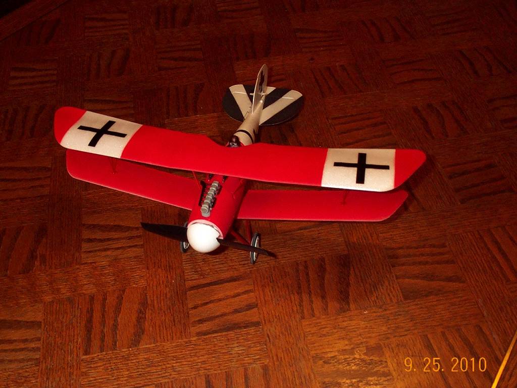

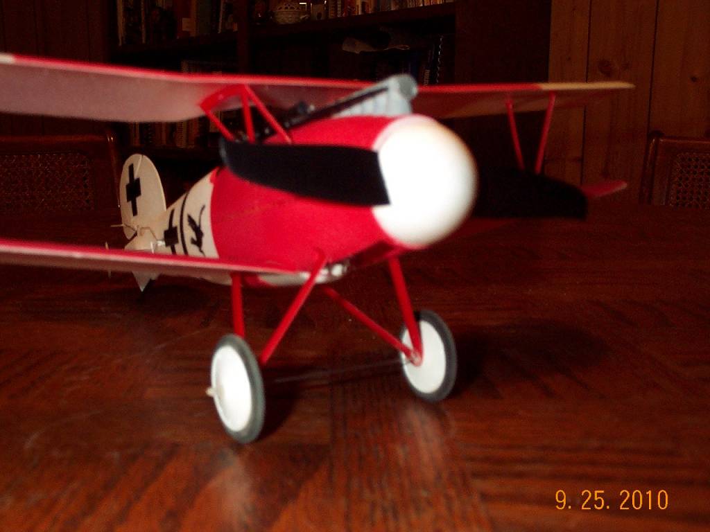

Notice the nice details
Engine, pilot, machine guns.
Looks like I need to add some instrument panel details.
Time to hit the sack and beat the wind in the morning.
My only worry is the PZ ESC may not last with the bigger motor. Keeping fingers crossed.
Is that a pretty airplane or what?!
Flies so smooth to boot.
David

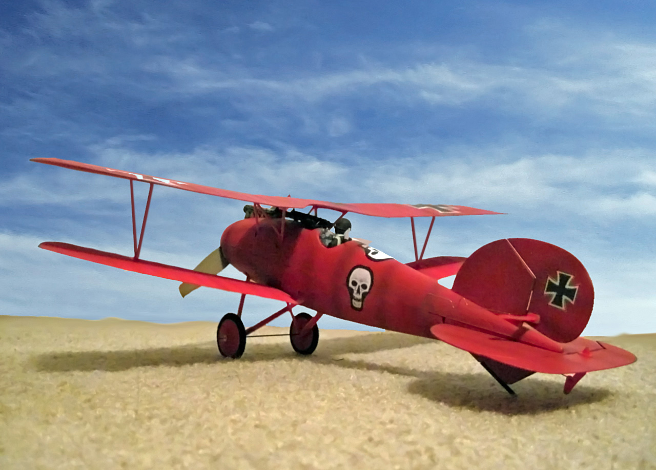

I love my Albatros!
However, using the stock radio gear, I found it a handful to fly in our basketball court-sized indoor flying area. I was ready to sell it, but decided instead to replace the stock receiver with one from a HobbyZone Champ.
It was an easy conversion and most importantly, I was able to mix the throttle and elevator channels on my DX6i. On my setup, when the throttle is lowered, the elevator goes up. This turned the Albatros into a great little flyer! Plus, the fact that it's a biplane gives it a 'certain something' that the Champs, Cubs, Vapors, and Embers just don't have.
Since it looks 'fragile', I figured the Albatros wouldn't last too long so I bought a complete set of spare parts. In reality, the Albatros is more durable than it looks. So, rather than 'waste' all those spares, I built another one based on the plane flown by WWI Ace Godwin Brumowski as seen below. It came out heavier than the original so it files differently, but not bad.
Plus everyone likes the skulls!

I had my first Albatros rebuilt and decided to go with something different
so here is what I came up with after watching the movie "The Red Baron"
It's going to be flying at the Fly-In at the Nutter Center in Dayton Ohio Nov 26th..
Mark
Mark
