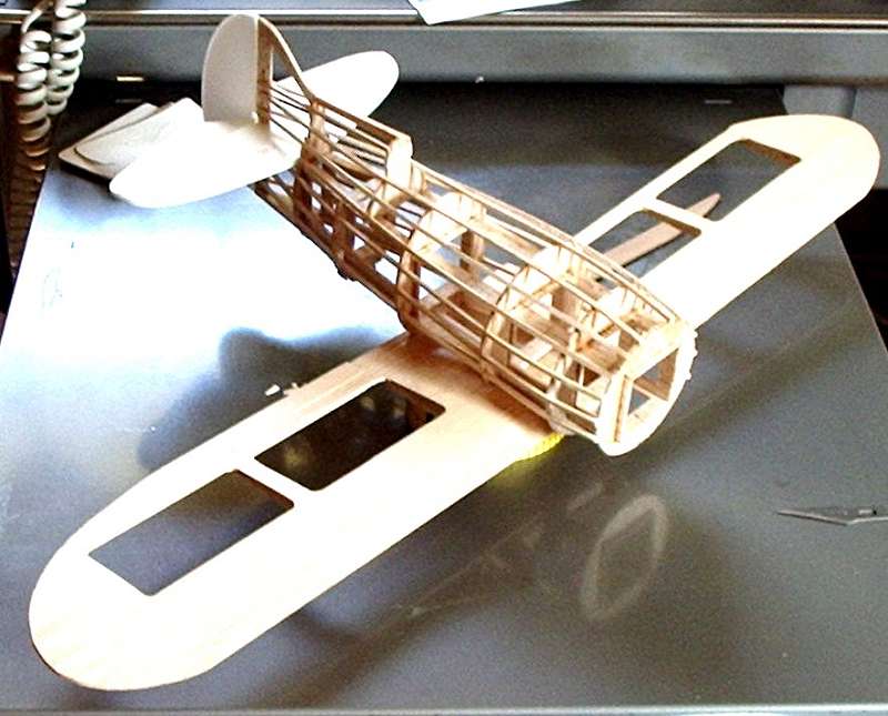

Heres a couple of hints at what I've got on the board right now...
It's always 'building season' here, mainly because its always flying (and crashing) season...

Beautiful work! I can only dream about a covering job that nice (I like those wheels, too). Looks like you're pretty near completion...

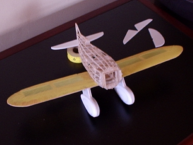

My tissuing could have started off better, but it may look better after I shrink it up a bit and paint it. I used the water/glue mixture and I think I watered down the glue too much - as the tissue shrank, it pulled up around the edges. I tacked them back down with undiluted glue, so the wings are back on track now.
The wheel pants came out fairly nice, although I think they "grew" between the drawing board and the workbench - I'm going to have to put one heck of a skid on the back to get the wheels to touch the ground before the pants...

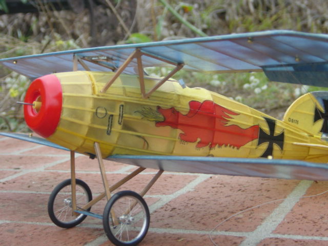

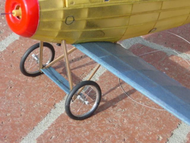

I got farther along in construction. The tissue is slack because these were taken between rain showers and its quite humid. All the covering is tissue with home-made decals for all the markings. The iron crosses on the top wing are bigger than is eay to handle.
The dragon was made from a graphic that was photographed from a book, and massaged in a couple of graphics programs. The tissue is sprayed with Krylon Clear acrylic.

The Albatross is looking great! Are the decals inkjet on tissue paper? I was going to paint on my "4" and "NR77V", but I may have to rethink that now. Yours certainly came out nice.

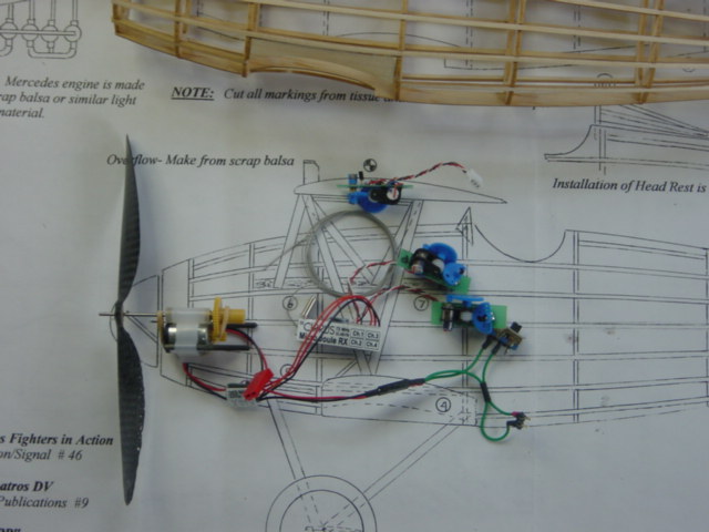

By the way, I forgot to ask earlier - I recognize the receiver, but what kind of servos are those? They look specifically designed for a pull-pull setup. That's not the MJ, is it?

The gear is a micro joule receiver, 2 Falcon 1.7 gram servos (pull-pull or push-pull), 1 mj servo for aileron control, mj ESC with shortened wires and lightened plug, charging system & switch, 2 x 170 lipolys, and N-20 w/4:1 Kenway gears. A few more touches and its ready to fly. I would prefer to fly this one indoors just to keep from shearing the LG off on gravel or grass...
