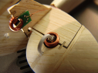

Sorry I didn't see this post earlier. Here is a look at a surface mounted coil actuator.
The coil splits the hinge-line, the magnet is centered in the coil and the magnets point fore-and-aft. I changed from brass wire to guitar strings for holding the magnets - the guitar strings pop back into shape after you snag a piece of metal with the magnets...

These explainations and the picture make things much clearer for me. One last question, the wire that holds the magnet, does it form a complete loop and attach to both the top and bottom surfaces?

The wire makes a small loop to hold the magnets, and then an arc comes off of that. I leave the tail end of the arc long, stick it through the surface, and find the right spot for a bend. I make a 90* bend and glue that to the bottom of the surface. A small dab of glue on the top surface locks it in place.
