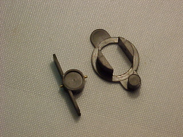

hey guys im having trouble understanding how to assemble the actuators with my RFFS stuff. im not quite sure what the instructi0ons are telling me and i dont want to start clomping arround with these delicate things. does anyone have pictures or instructions on how to assemble them? thx chris

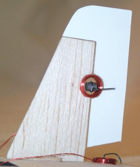

Put the arm assy into the black round insert first and check to see it rotates freely. Now slip it in the coil and note the arm's plane of rotation relative to the circuit board as shown in the manual. Only the barest of CA is needed to secure the insert to the coil but UHU would be better. Use a toothpick and the pointiest end for the smallest amount of medium- thin is too dangerous here- don't ask me how I know!

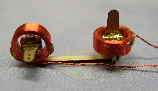

Here's a picture that shows a critical part of the setup- their orientation to one another.
Mutual magnetic centering and non-interaction is vital to these spooky lil guys. I had them offset in my original Micro Pitts. Aileron caused some elevator interaction- and the elevator, likewise, induced an unwanted reaction from the other! Not fun to fly! Lets see you program THAT outta your TX! Moving the rudder servo into alignment with the aileron servo fixed it.

On the basic actuator I made the wires wrap around the round magnets a full turn to make it more secure before gluing it w CA. The magnet floating on the hinge wire within the center of the coil is a delicate thing to install on the basic hingeline actuators. The magnetic actuators are more difficult to install than conventional servos but are a bit simpler than the pushrod method. Either one will get you slower, lighter flight than you've ever had.

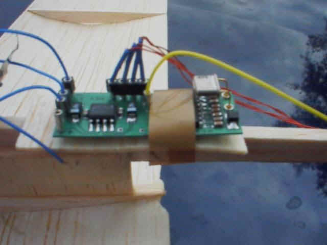

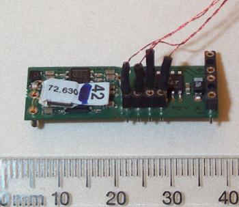

The actuators connect to the RFFS-100 receiver by two wires from each coil. The RFFS-100 is a 3 channel receiver with built in speed control good for up to 2 amps. If the actuators movement is reversed, simply swap the 2 actuator wires in their sockets in the receiver and its done. The tiny circuit board on the coil is a place to attach wires as well as a reference for orienting the actuator properly for mounting.
The picture shows the RFFS-100 with both actuator's wires plugged in with their 4 wires. The tiny crystal is to the left on the board. The black connector strip on the right feeds the motor from the center two holes and battery power is connected to the two outside holes. There is no switch. Get the polarity right every time- there is no protection for reversed polarity.

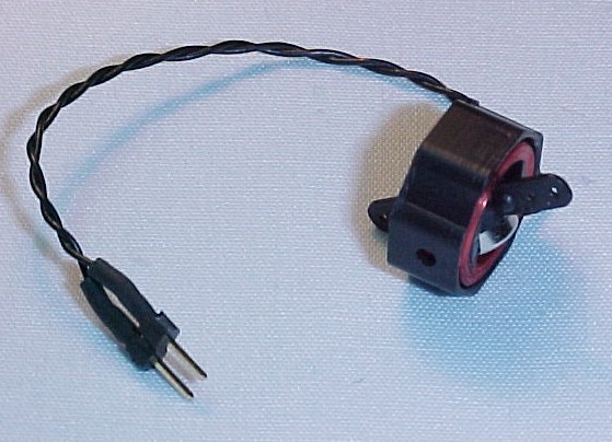

The actuators are mainly a coil with a magnet held in it's center The moveable magnet is driven by the coil's steerable magnetic field which is varied by the stick position for the rudder and elevator controls. Completely proportional. 3 channels, very long flights- for mere grams! The lightest and the slowest.
Also pictured is a new actuator with an output arm for driving a pushrod. These have larger coils, making them more powerful- and heavier. They are for mounting near the center of the fuse to keep the tail light- but require careful setup for magnetic non-interference with one another.

thx deltageek. i think i found the problem with mine.......the magnets didnt fit in the arm and they were binding on the side and not centering. i ordered a better set of hardware now and i think it will fix the problem.
