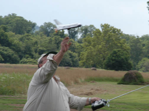

Here is a layout photo, a before flight photo and launch photo at SMALL Steps 2004 last year.......
