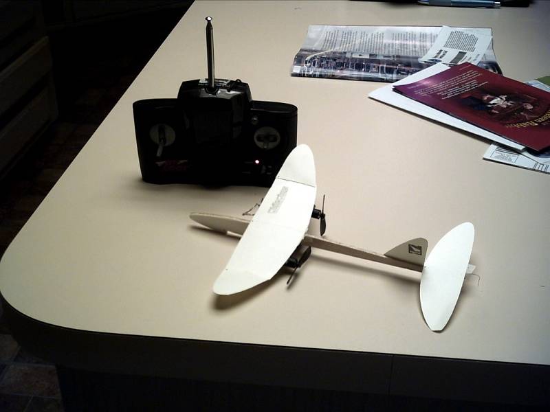

first of all id like to say to the people who run internet explorer i hate you. i had written a whole half page about this and then it has to say theres an error and it restarts my computer . now im in a bad mood and im only gonna post the pics. so ask me questions please. im excited about this plane.

looks good if you've got yourself some thin balsa, you can swap out the heavy cardstock and shave quite a bit of weight. the cardstock wings and other parts would make for perfect templates, i'll have to remember to look for the white wings next time i'm at the LHS. looks like its got a small span, 8 inches? i bet she's fast
edit: we were typing at the same time so i was right, she's quick. thats what i'd call a "3/4 flyer" as in, it takes at least 3/4 throttle to stay in the air!

hmmm balsa? thad break easyer. yes it is fast. in the first flight it went strait down{i hadnt leveled it yet} and it stuck an inch into the hard texas soil.

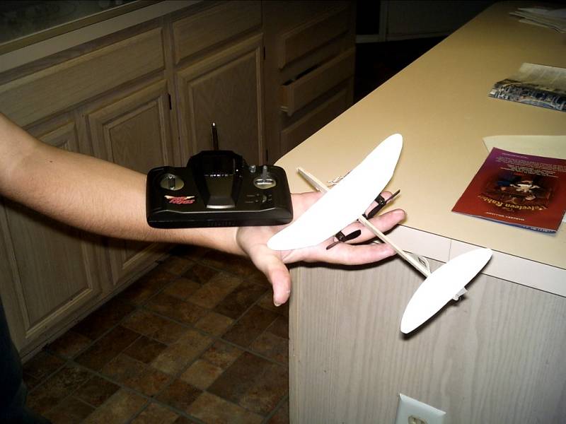

ok, i promised more pics. the white wings kit ,came along with 5 other gliders and a launching stick.

I saw the above pics! Really cool stuff. I've never messed with micro... can you fill me in a bit? Can I use a full size transmitter? Like my jr 9303? Can you explain the components used for conversion... what type of rx, and motors etc... also where can I buy them? Thanks!

the electronics are from the AirHogs AeroAce, two 5.3ohm 6mm coreless motors, one 130mah lipo, and a 2 channel thrust differential RX/ESC. the signalling is propriatary, so only the AAs TX will communicate with the RX (unfortunately). a very small handful of people have made their own TXs though, but they had to do all the programming, ect, for it to work. all it takes is about 5 minutes to remove the electronics from the AA and even less time to reinstall the electronics into your own plane. the two motors together put out around 10 grams of thrust, so you'll need a total weight of 25 grams or less (the electronics weigh 10-12 grams, so that leaves you 10+ grams for the airframe). they're selling the AAs just about everywhere now-days, walmart, k-mart, target, toys r us. prices are 20-40 bucks depending on where you go and if they have a sale going on.
