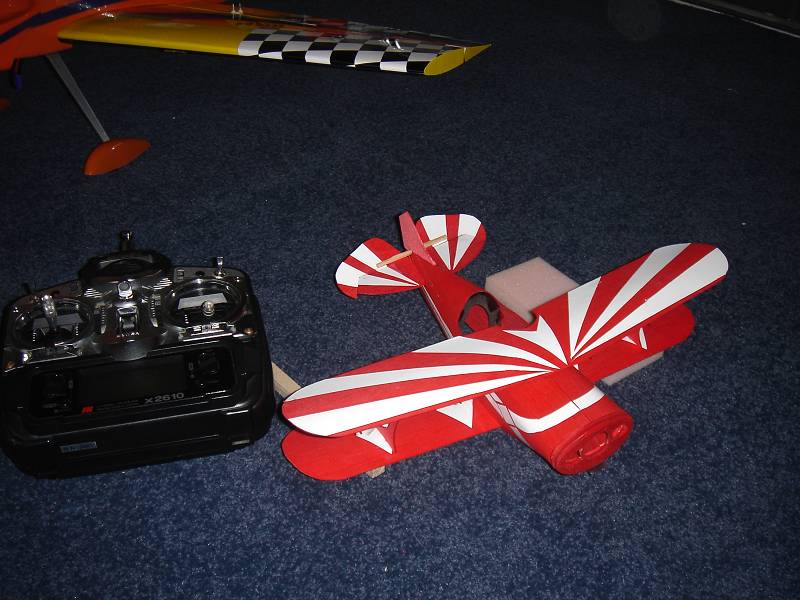

I've been slowly getting micro gear for this little project. It is a scaled up version of the micro pitts by Chris O'Reilly. The original has a ws of 12 inches and weighs about 24grams. As it was going to cost me $80 to ship plantraco gear I scaled it up to 125%. WS is 15" ,AUW is 48.9grams without pushrods.

Size comparison to my Peak models Cap 232, 920mm ws...

complete waiting for installation of electrics.

nice work did you use tissue paper for the color, or did you paint it? is it balsa?
i have the same set of plans and have always meant to build one, but never got around to it. what size of motor are you using?

Thanks for the compliments Nick, It goes together fast.
Mike, There are no 2 cell esc's in Aust and the importer has no plans to get them in [&o]..... This is after telling me they had them in stock and I ordered it only for the 1 cell ESC to arrive. I have grave doubts my motor (dragonfly tail rotor motor) will provide enough grunt direct drive and am hoping to find a gearbox setup.
If I scaled it up some more I would have heaps of stuff for it and many more options but then it would lose the 'cuteness' factor.

I forgot to mention I tried postbox red food dye which gave it a really washed out colour. I ended up settling for a light misting of spray paint on th etop surfaces and fuse.... added hardly any weight as it just deepened the red.
