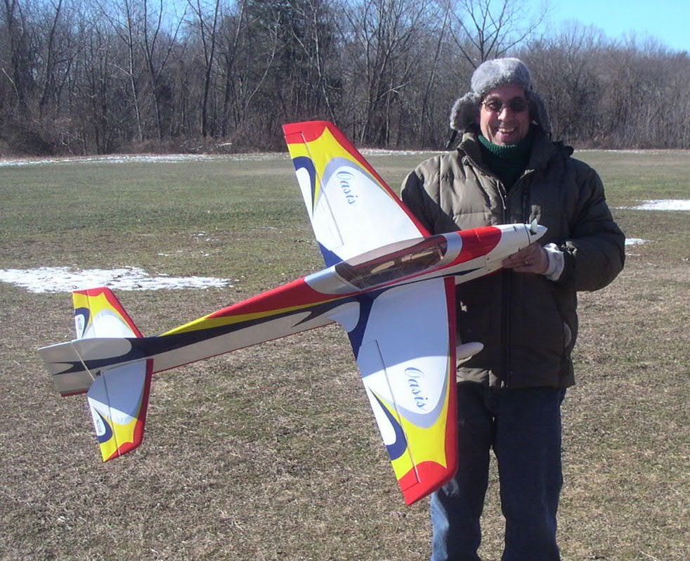

Hey... nice picture!!
How do you put the pic in these E-Mails?
