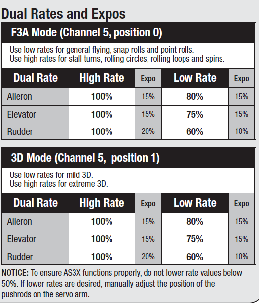

Channel 5 (gear) turns stabilization on/off

no it doesn't!!!!!!!!!

I stand corrected. When I first started using it, effectively that's what I observed... It seemed to turn stabilization on/off. Looking at the book it seems that it changes from F3A mode to 3D mode. The table laying out the values is here:
