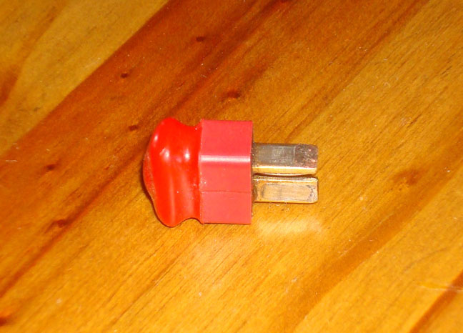

This arming plug has about 450 flights on a 5s system. The spade which is facing upward gets arc'd every time I plug it in resulting in a black oxidation over the end 2mm of the spade. Flash has washed it out in this picture but it's there. I've sanded it off 3 or 4 times over its life. Maybe about time to replace the plug?

Thanks Scott,..I was getting ready to take mine out. I chucked the plug before it ever got rolling (Anderson type plug). It locks but not very well, but thanks for posting that rule. I guess that is a newer rule?

Interesting. It takes 25 pounds force to unplug the APP. I secure my wires so they cannot flop around, but I do that to avoid stressing where the wire connects to anything. I've never had a plug pull apart in either my planes of helis.

Never had one do it either till now and I secure mine when all possible. This connector plugs into a block with the other end secured to the inside of the block. The App is out side the plane unsecured. Mine falls out when I go to half throttle and before that happens you can hear the ESC beep, indicating it just lost connectivity.

I think the force to remove an APP is 2-3 lbs, assuming it is assembled right and nothing got bent. The 25 lb looks likens type-o. I have had one disconnect and melt, not necessarily in that order, because i was lazy and ignored the loose feeling connection. The plug in / removal force is not always consistent, and I do use name brand APPs with the ratcheting tool. Sometimes the contact needs a minor adjustment.

Just going by what they publish as a spec:
http://www.powerwerx.com/techdata/PP45.pdf
Connector Model PP45 Connector Model PP45
Contact Retention Force (lbf) 25
All I know is that none of mine have ever separated in flight or at any other time that I did not pull them apart.
