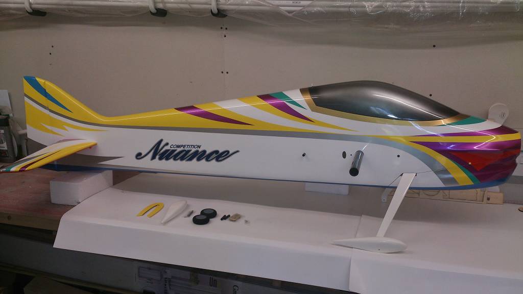

Just picked up my Nuance 120 from Chris at 'Bondaero' and wow is it impressive! Usual fantastic finish from BJ with some neat little updates. The canopy fitting has changed which I actually prefer to my 170 version and also this version comes with optional wing adjusters as part of the hardware, complete with a set-up jig.
I'll post up more pics as I get to grips with the build.

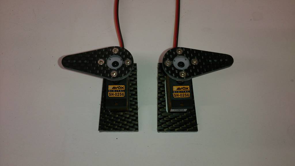

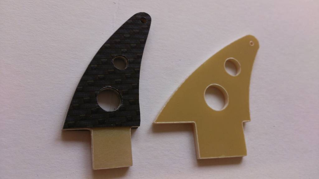

Had a little more time on the build today. First up was to get my output arms mounted up on the elevator servo's. This was an easy fit by simply marking up the round servo discs for drilling the 2mm retaining bolts for the carbon arms and then bolting them on. Naturally I rotated the discs to find the best centering position so as to avoid using big sub trim amounts.
Next up was to make some ply mounting plates for the servo's. The cut-outs in the stabs are sized for mini servo's but I opted for the Savox micro's ala BJ style. No big deal, simply made up some card templates and then used them to mark up some of the ply that is surplus from the laser cut component sheets that come with the kit. After these had been cut out I then laminated them with some of the carbon sheet I have in stock, it's 0.01mm thick autoclave sheet that I got from one of our team members over here, simply cyano'd into place.
I'm gonna get the scales out next and get some weights recorded before I go any further with the build, I'll post the data up as soon as.
A couple of pics from today.

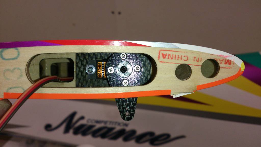

Update: A pic of the installed stab servo.
