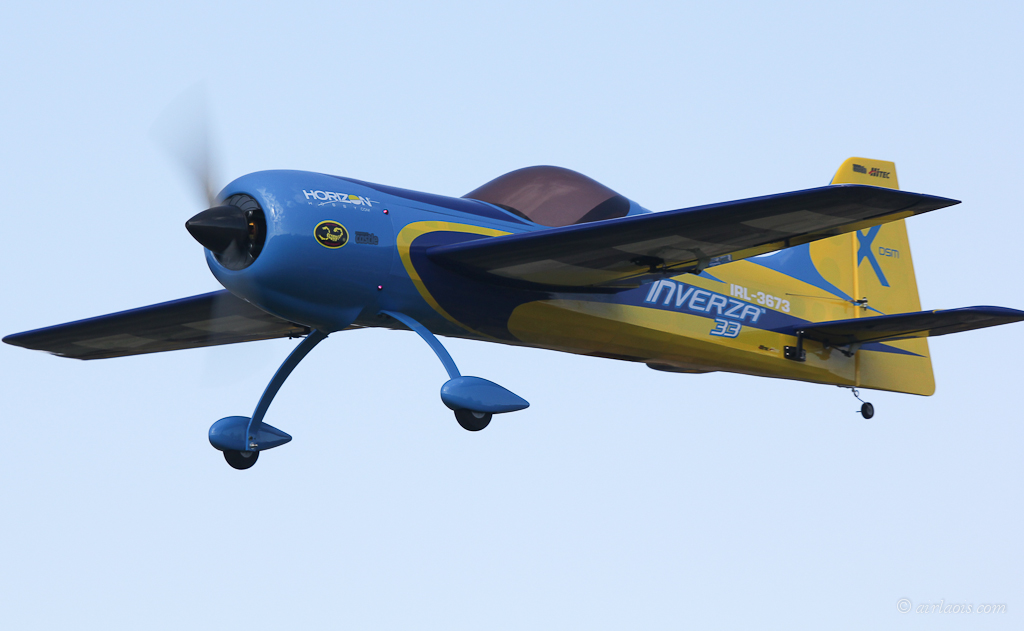

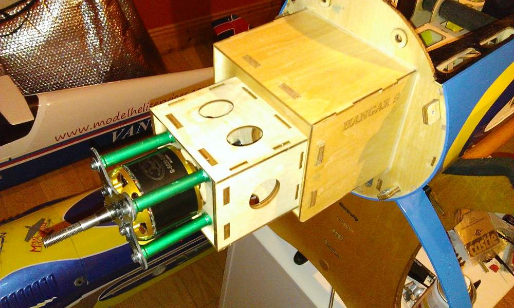

Old 06-06-2014 | 03:14 AM
blake26m's Avatar
Joined: Dec 2013
Posts: 83
Here is my Inversa im using for IMAC Intermeddiate at the moment. Scorpion F3A motor, CC 120 HV and 4700mah 10s. About 7:30 mins of flight time.
