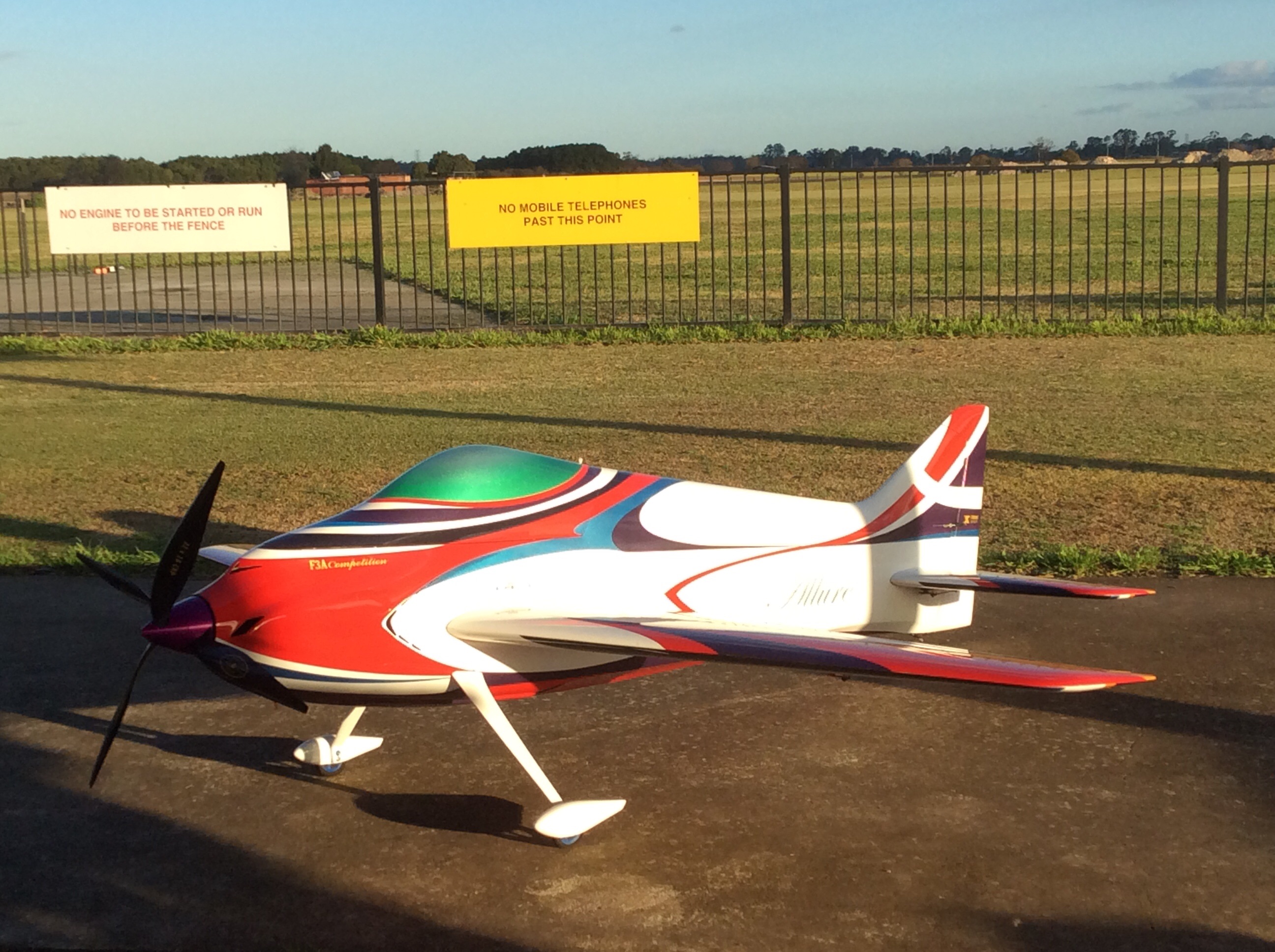

Hey Guys,
Bryan and Brett have put together a great video on the WC Allure here: http://youtu.be/u1BuGSTbVVo
There is also a video of Brett flying F15 here: http://youtu.be/_DyqMjOFOUE
But wait, there's more... Bryan has now got Chips model on the work bench...
Cheers,
Jason.

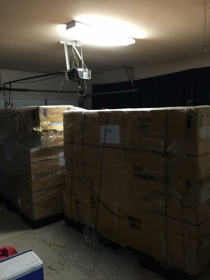

Hi Guys,
CK Aero has received the first half of their shipment from the factory and the other half is being shipped next week! They will be shipping out to Customers in the next few days after Bryan inspects and Sorts through each of the models.
CK Aero will have 6 models unspoken for and available for sale in August/September when the new order arrives!

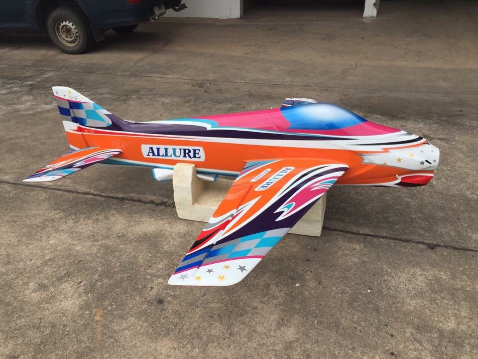

Very recently, Bryan called me and we had a very good discussion on these sort of issues and I'm very proud and happy that I made the decision to go with the Allure. Thanks to Bryan, I'll be receiving the #001 Signature Version Allure and I can't wait to get it. Bryan offers something that we usually don't get from other manufacturers, the ability to closely inspect and fly his design, along with the ability of dealing directly with Bryan should the need arise. That added touch gives one the feeling of confidence in making the Allure the Pattern plane of choice. Guys, if you have never flown an Allure, let me suggest that you attempt to do so. As the Quicken Loan commercial goes, "Truly built to Amaze", the same is true for the Allure.

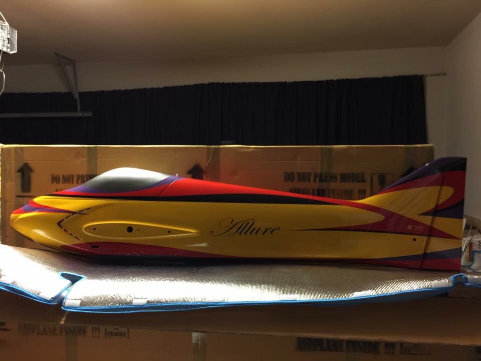

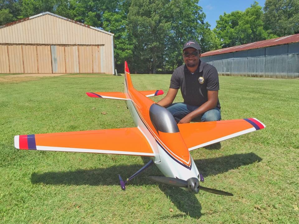

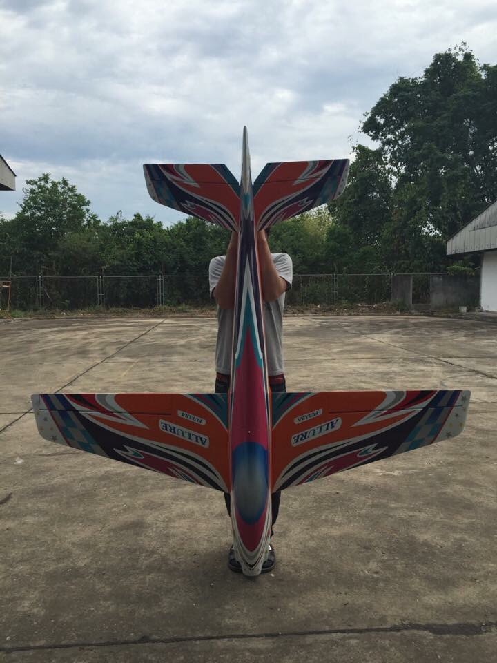

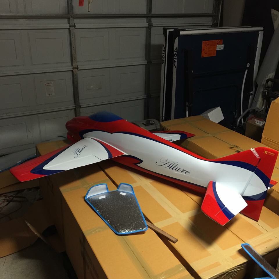

Bryan sent a few pictures of my new Allure to me. I'll be using a 3-blade Falcon and a Neu / Castle Phoenix Edge HV80. The plane came in at 2320g including the landing gear from the factory. I expect this plane to be flying under 4800g with light batteries.
I want to mimic the Contra Allure prototype that I have without the expense of the Contra unit. I think the 3-blade prop will be great on this plane. This will give me two Allures that I can be very proud of. We should have this one in the air shortly.

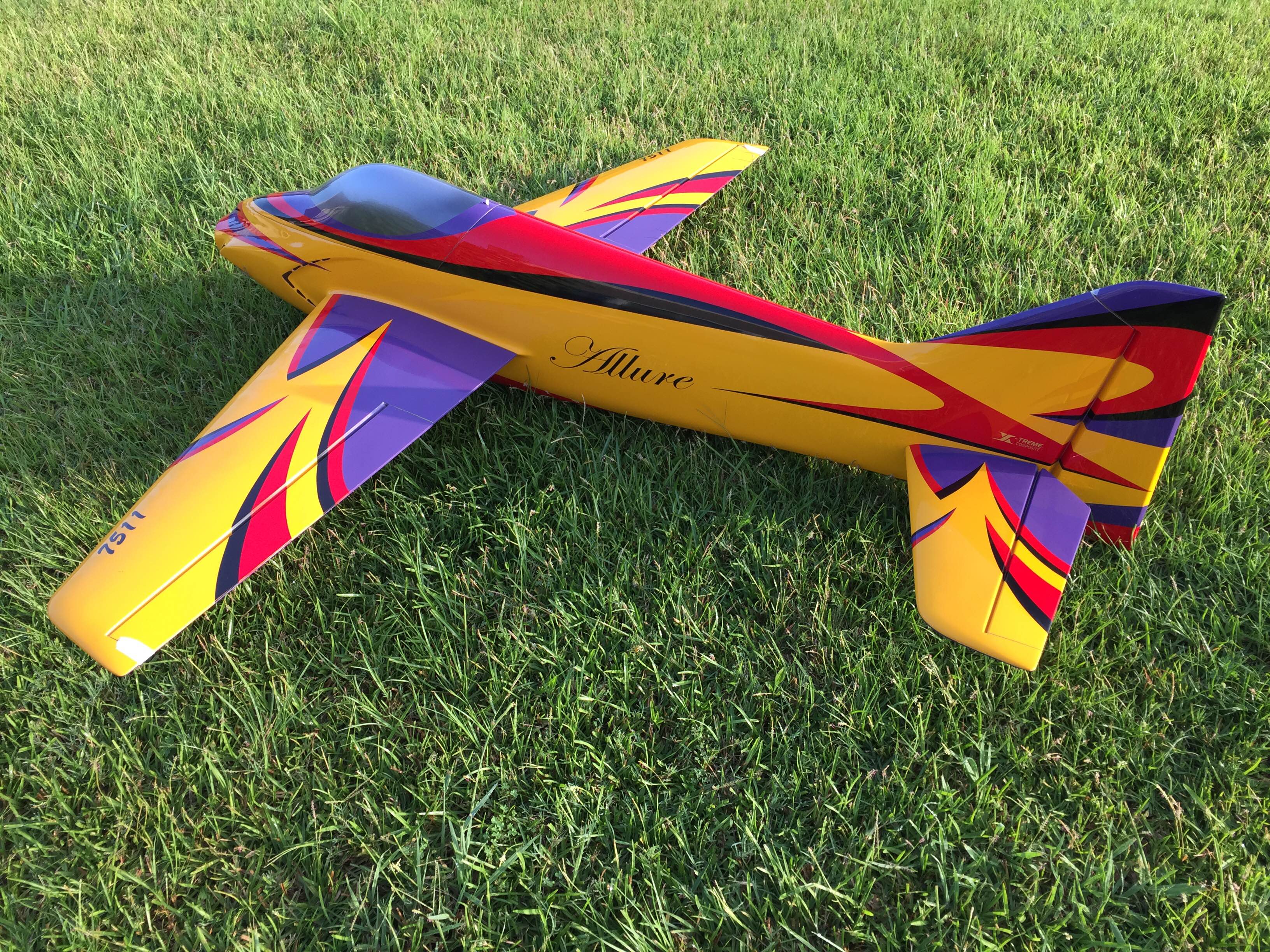

Hey Guys,
Just kinda getting around to writing this up but have been meaning to get this out but with prep for the Nats its been a little hetic.
First I want to thank Tommy Goldsten for building my Allure for me and getting it out the door to me pretty quickly along with Bryan Hebert for all his setup work.
Now that I have had some real time with the airplane I can give a honest opinion of the airplane and its flight qualities.

Right now I have about 180 Flights on the airplane and must say I'm quite impressed with the performance of the airplane. Running Bryans setup incidence and CG wise the airplane is a very stable airplane in all aspects. The only mix I'm currently running is a throttle to elevator mix for downlines. Knife Edge authority is pretty impressive as I have found working more and more on unknown manuvers. Many of you that have seen me fly know that I fly at a more upbeat pace. I have found that rather I fly the Allure fast or slow that the airplane really locks in on a line and will do whatever you tell it to do. The airplane is really a point and go aircraft.The snaps are very predictable along with the spins. I have done a variety of snaps with it from 3/4 snaps to 2 and half snaps and found that hitting them are absolutely no problem at all. Overall I'm very pleased with the airplane and really looking forward to the nats next week. I will have a video up within a week of the airplane flying P-15, F-15 and Unknown 2 from last years nats. Once those are live online I will post the link for everyone to view.

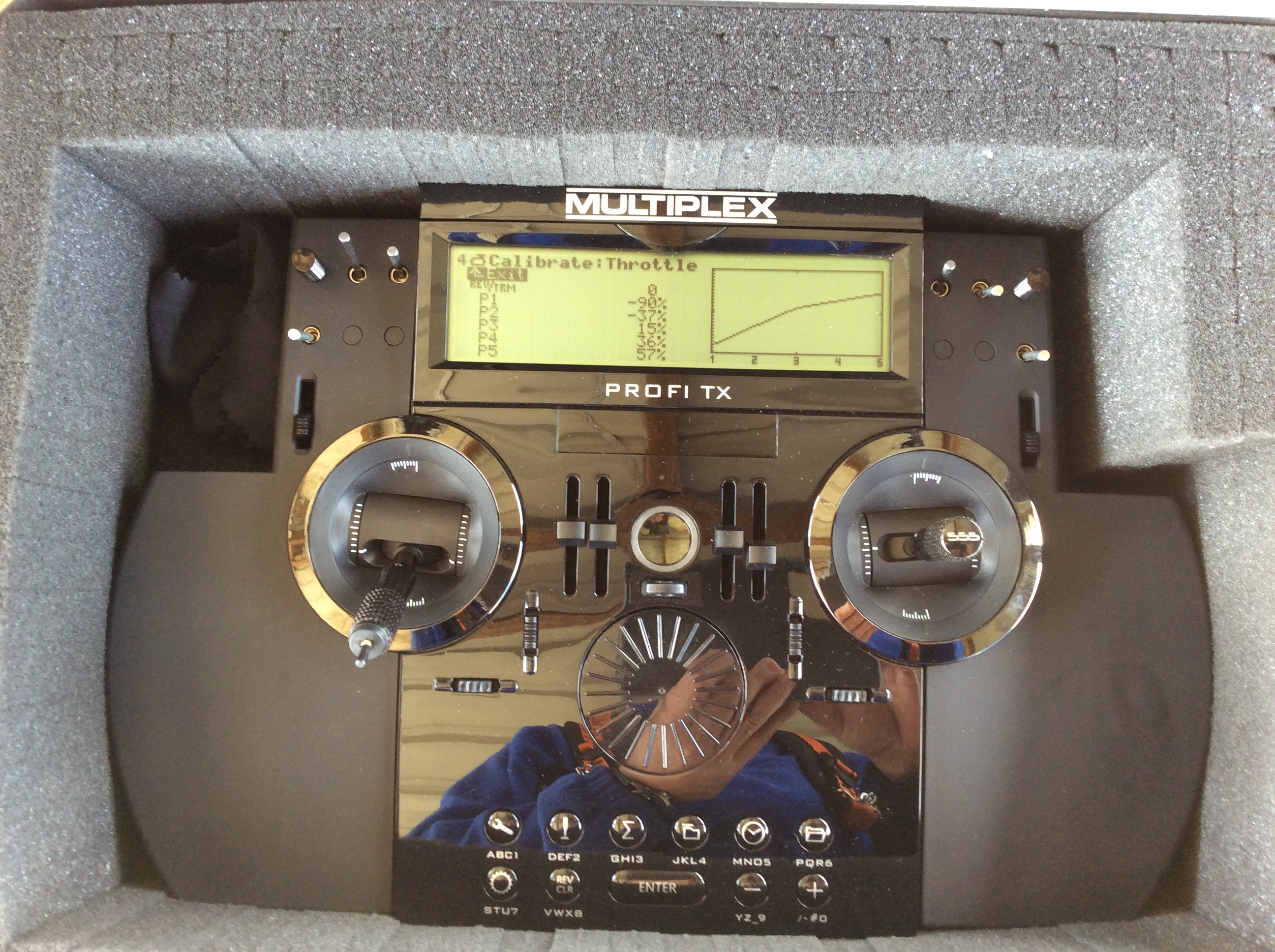

Well, that was the best days flying I've had for a long time. Put nine flights in on the Allure six of which were with 22" props. Because the model had been flown for so long with 20" props the difference was stark! The gear ratio was left the same at 9.89:1 and the lowest consumption for a P15 schedule flown big was 2601mA. I should never have doubted others claiming this sort of efficiency! These figures are achievable even in the wind. Overall, the model now flys a bit slower but surprisingly doesn't get all waffly. I found that no more than half to two thirds throttle was needed as well. I think the bigger props even improved the horizontal rolling manoeuvres. The three of six in opposite seemed noticeably easier.
I was asked about my throttle curve elsewhere so a picture is attached. The way I adjust my end points is probably a little different to most whereby I do it by ear. :-)

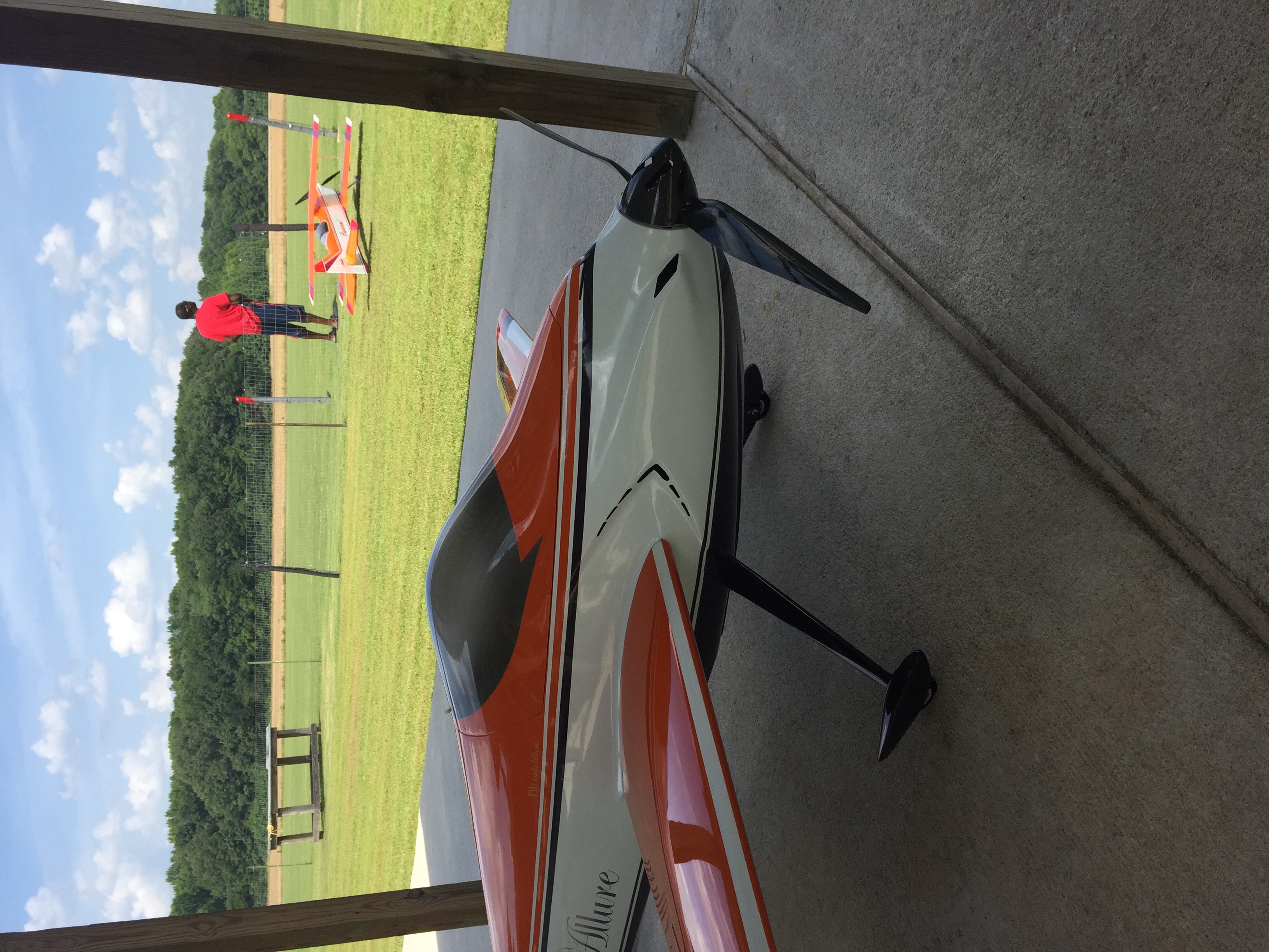

It's still early days but the Allure currently fills the top three spots at the U.S. Nationals in FAI class. The order is AC Glenn, Chip Hyde and Dave Lockart. Good luck guys!
Cheers,
Jason.

I was out practicing yesterday when Bryan texted the scores to me, and then I realized that I had a message on my cell phone from my buddy Glen Shepherd, telling me that AC Glenn had won the FAI finals. I was not able to make it to the Nats this year but I'm always very excited during Nats time.
Congratulations to the top 8 pilots who made the FAI Finals and a special congratulations to AC Glenn, 2015 FAI Nats Champion, and our own NSRCA District 6 Mark Hunt, who was the 2014 Nats Masters Champion and 2014 NSRCA District 6 FAI Champion, and this year placing 5th in the FAI Finals. I spoke with Bryan on the phone yesterday, it had not really soaked in yet, as to what historic event had taken place....His Allure finishing in the top 3 positions in the 2015 FAI Nationals.
This just goes to show that Bryan has really outdone himself with his new Allure design, quite possibly making it the most winningest and most popular Pattern plane on the planet. Congratulation also to Mr. Bryan Hebert. As I stated in post #367, 'If you looking for a Pattern plane that will definitely give you the edge and you haven't flown one yet, you definitely need to fly and buy an Allure.
I'd also like to congratulate our own NSRCA District 6 Vice President, Chuck Hochhalter for placing 7th in Masters, and, 2015 National Champ, Jeff Worsham for his 1st place victory and Nick Marson for his 3rd place victory in Intermediate.
