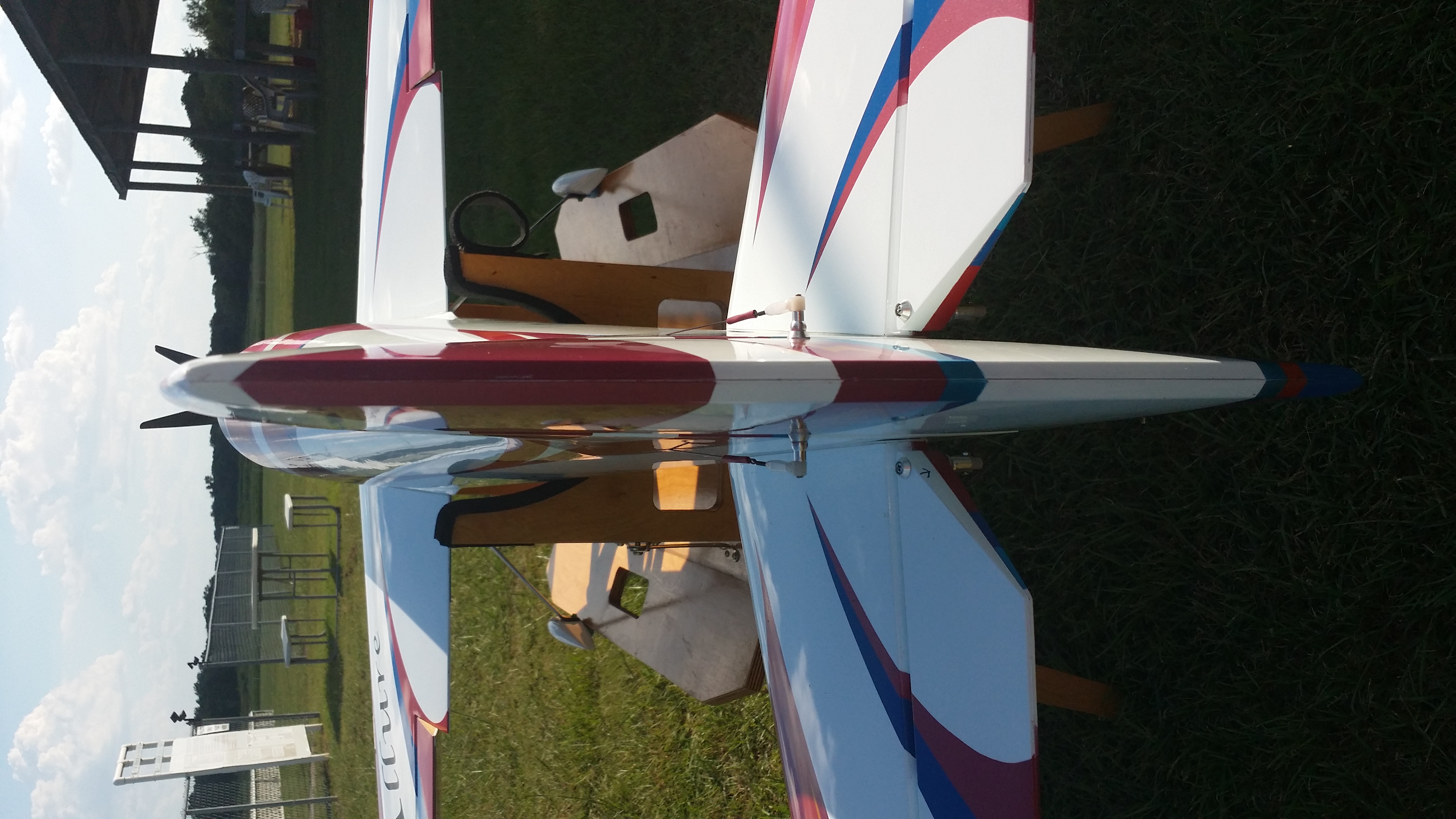

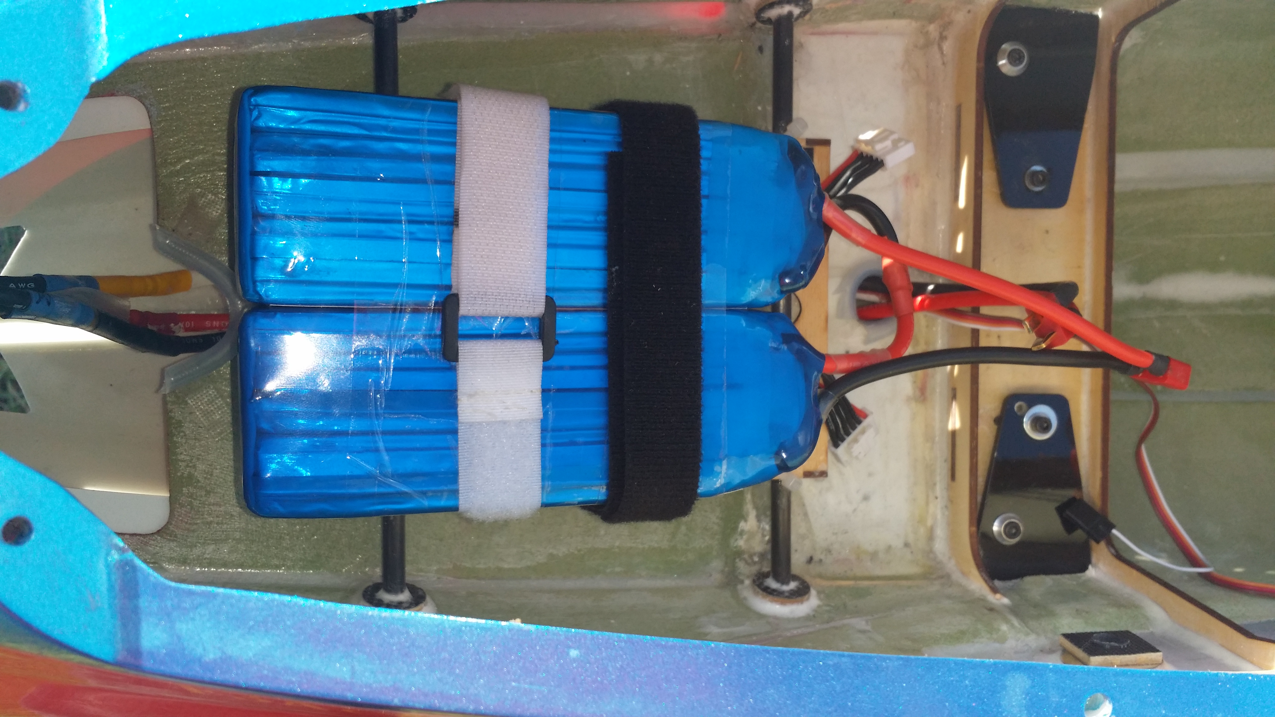

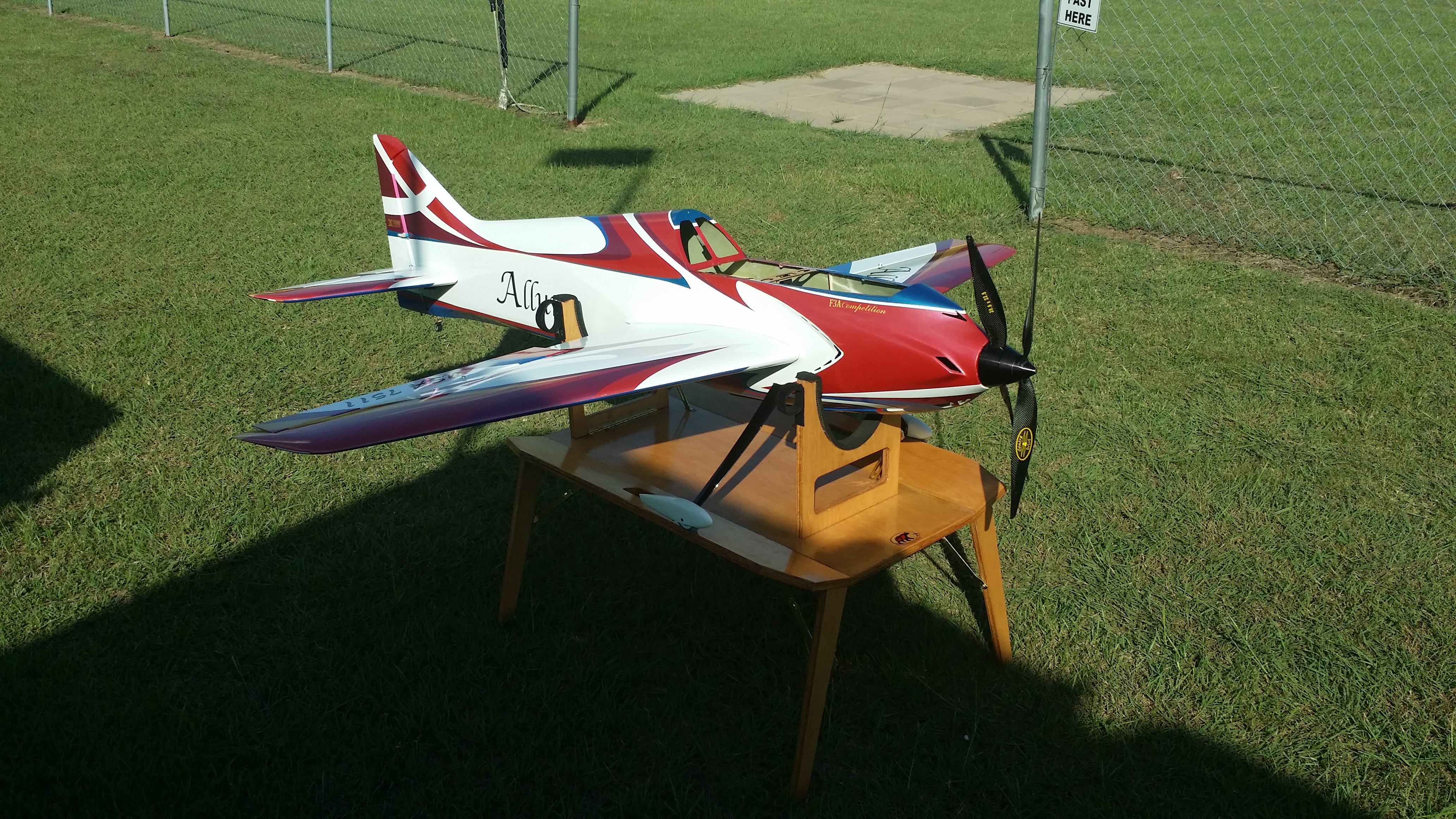

Here are a few pictures of how the battery tray is situated to show ease of access to the compartment and a shot to see how far forward the opening is for the canopy on the prototype. This is at the very front of the opening and with the production model, the canopy opening is even longer for the electric / Contra Allure. As in the "First Impressions" video, Bryan has decided to make a second mold for this plane which will feature a non-removable chin cowl and no sub-floor for total access as well as the extended canopy opening. This will reduce weight slightly from an already impressive number and increase strength.
Sunday, I put 11 flights on this airplane beginning to learn it as well as the differences in the application of throttle with the Contra vs. a single prop electric plane. Let it be known that I have not flown the Allure in any other configuration so I'm not at a point that I can say what the differences are without the Contra. What I can say is that this plane and this Contra unit are well matched. The constant speed of this Allure honestly surprised me. We didn't put any braking into the ESC as Bryan felt confident that with the size of the plane, it had plenty of drag. I agreed but still thought the plane would be rather fast on exit of a down line vertical to horizontal. This was not the case at all. The plane exits out of the vertical just wonderfully and, unlike all the other electrics I've flown, you won't coast very much. This is due to the constant speed.
Yesterday, I put another set of flights on this airplane and will fly more today after work. I've played with the CG a little bit but have stuck fairly close to where Bryan wanted it to be. The purpose was to see what the differences were in the flight characteristics based on small CG changes. There really was little difference aside from the spin entry and wind penetration. The further forward the CG, the better these two facets were. Again, my changes were no more than 2% MAC but the good news is that this plane is obviously going to have a wide CG range that it will fly very well at. At this point and with as few flights as I have on it, I just need to learn the plane and figure out my settings for expo and rate. The plane needs no mixes at all except the typical elevator to idle. Not one other mix is in this plane. I still don't understand how Bryan can think of something in his head and just know what to do so that a plane needs no mixing. Sometimes you have to look and wonder if there is something he's doing and not really saying but I'm a witness to the fact that there is no hocus-pocus here. It truly is in the setup and design.
I think the thing that impresses me the most after only 15 flights is how much lift the height of the fuselage offers. You actually wind up waiting to input rudder in rolling maneuvers. The fuse provides enough lift that very little rudder is needed here. What this does, at least for me, is make the rollers much easier to do. It feels like you are simply coaxing the aircraft for the minor corrections it needs due to external forces instead of having to use your pilot skills to do the maneuver. Essentially, it allows you to lean on the plane and use it as a crutch instead of the airplane using the pilot as the crutch.

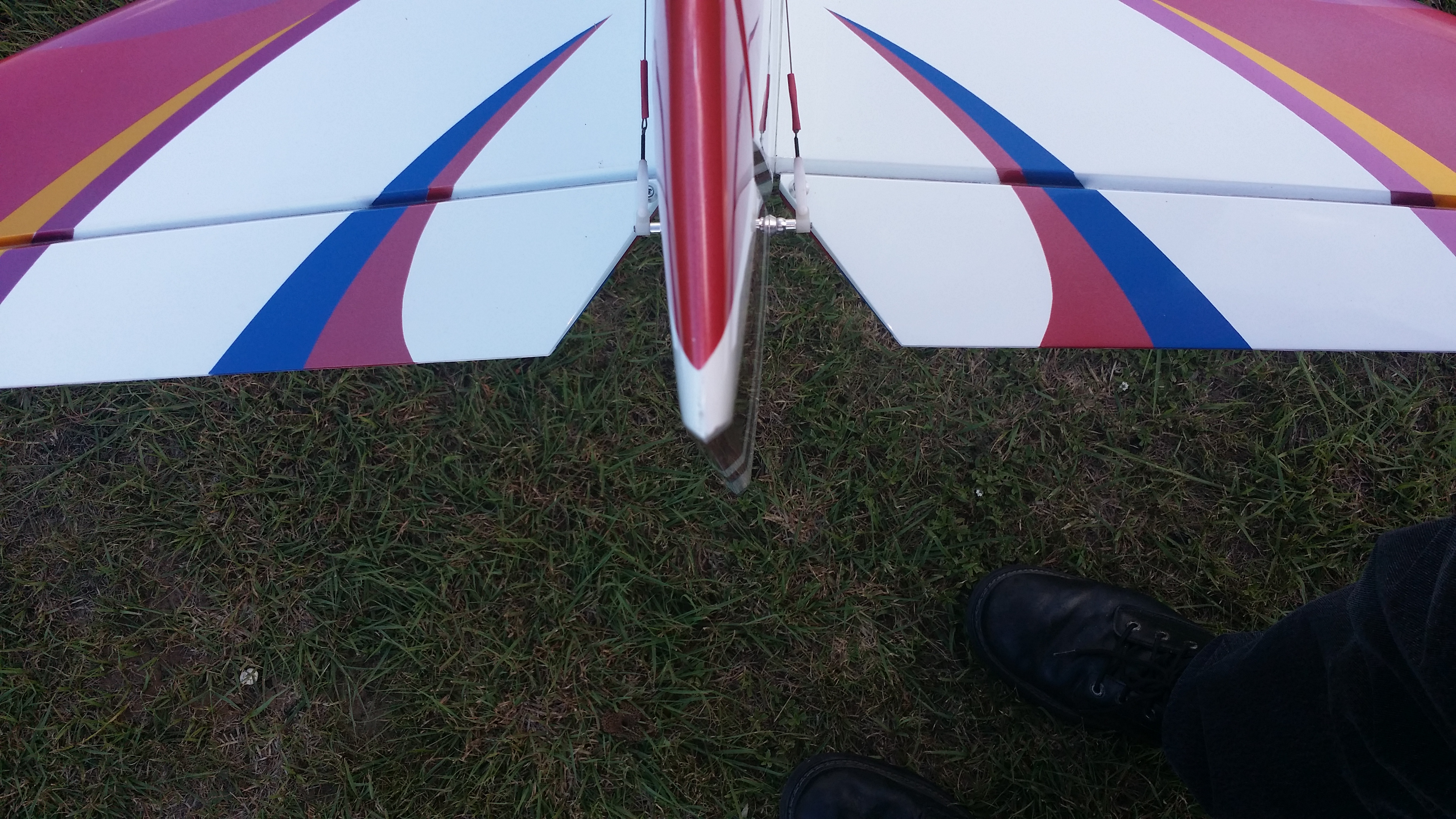

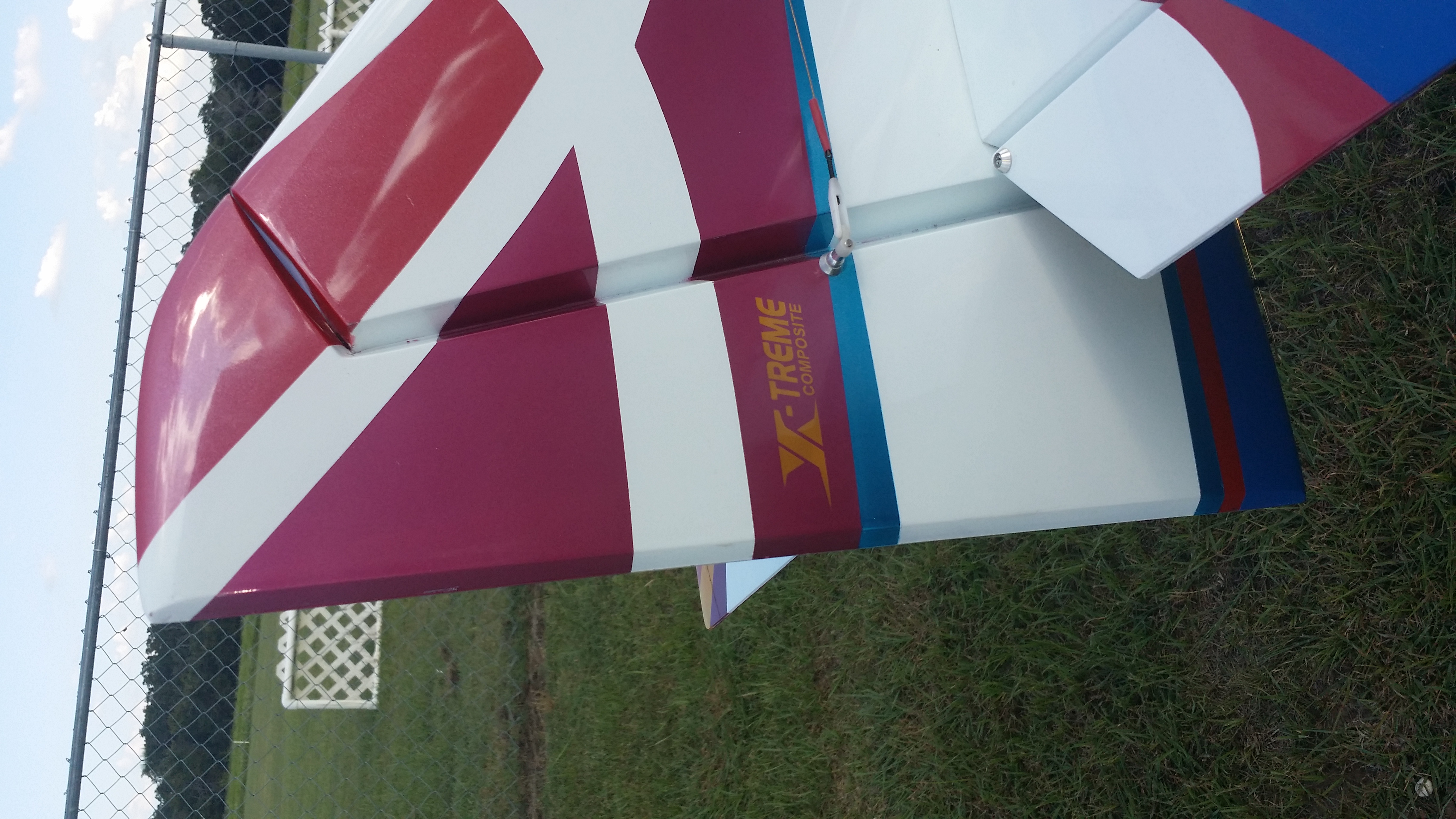

I've also included the pictures of the trailing edge of the rudder so y'all can see the reverse flair Bryan is talking about. He can go into detail.
Essentially, there isn't anything added to this airplane to make it fly exceptionally well with the Contra. I am honored that Bryan gave me the opportunity to fly this plane for a while. It will be a sad day when I have to give the plane back to him but a great day as well because that means my Allure will be ready to take flight!
