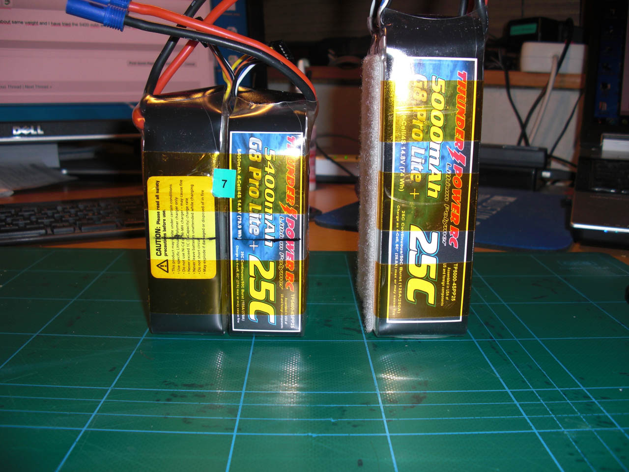

The reason for asking the question was based on something I discovered while looking at the ThunderpowerRC website.
It would appear as though their G8 25C 5s 5000mA pack (574g) weighs the same as their G8 25C 5s 5400 pack (573g)
(Granted, the pack dimensions are different but nothing that isn't manageable)
Interestingly enough, the $ per mAH for each pack is about the same.
That made me wonder if there was a capacity requirement that would make someone use the 5400 rather than the 5000.

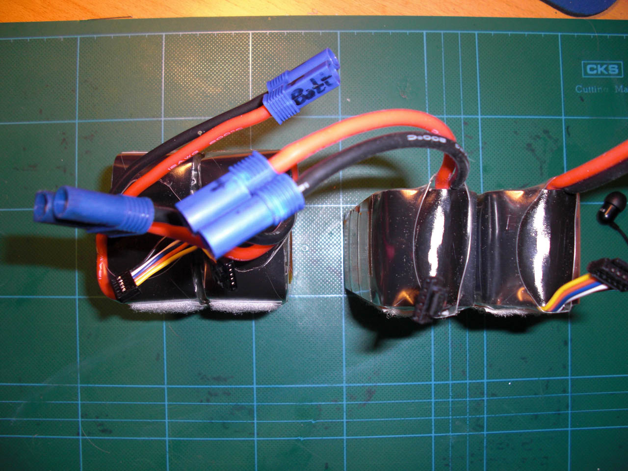

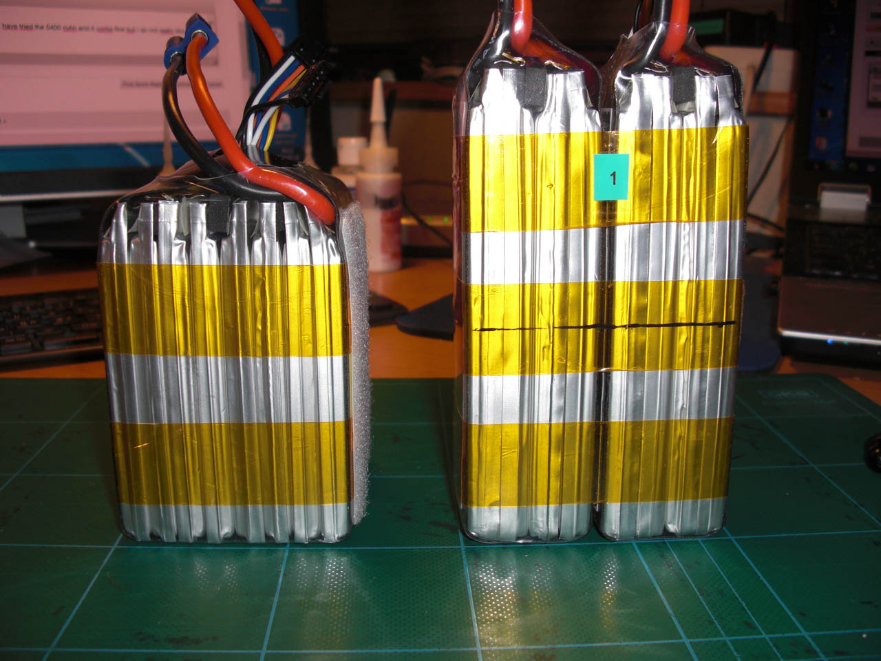

About the form factor on the ThunderPower LiPo - 5000 vs 5400 mAh: Yes they are about same weight and I have tried the 5400 mAh (4 cell x 2 in my MythoS 125E) and it works fine but I do not really like the tall pack. I prefer the lower profile 5000 mAh. See photos below of comparison of the two packs.
/Bo
Above is with Hacker Q80-14XS and Falcon Electric carbon V2 prop 20.5 x 14.5.
/Bo

Thank you for the reply and photos.
I called Thunderpower and asked about the 5400 form factor. Apparently they are a replacement for the previous 5300 mAH F3A packs, since they are closer in form factor than the 5000
