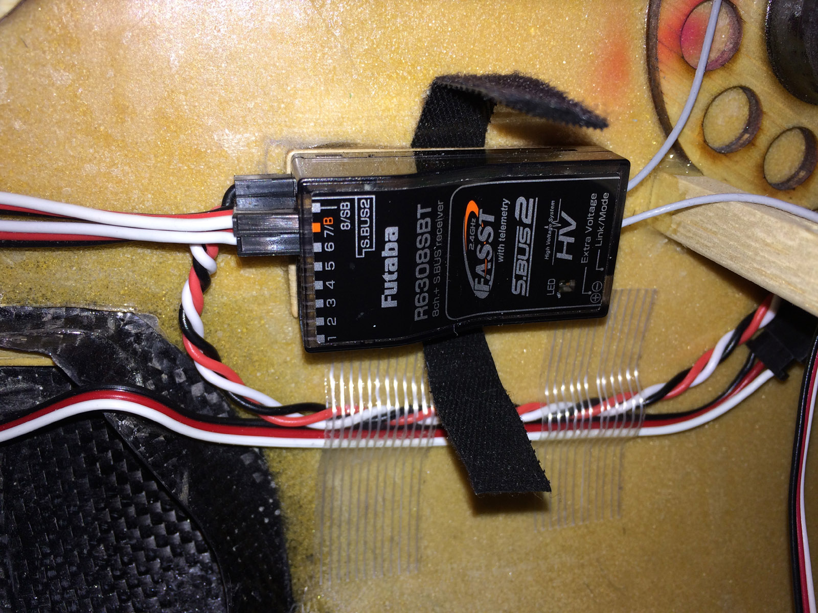

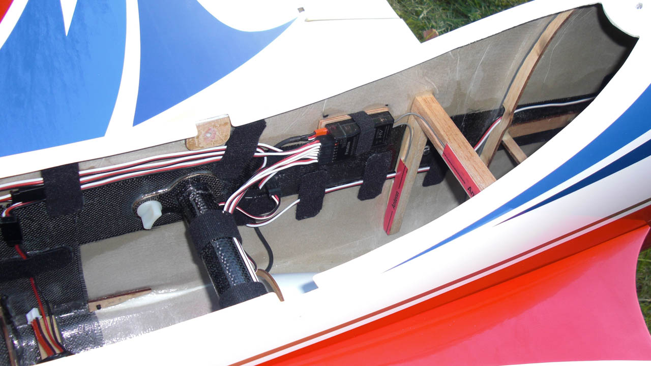

Hi,
I have receiver mounted to the side of fuselage in my MythoS Pro and Galactika.
The reason is for me: very easy to mount, very low weight on the mounting plate and might help to keep servo lead length short and that way save a few grams in weight. I have moved over to S.BUS2 in my Galactika so the servo leads are are even less, saving more weight then otherwise.
I have not found any disadvantages with side mounted receiver (yet).
My receiver weight is 11 grams. It is no problem (in my planes) with flexing of fuselage side where receiver is mounted.
I use some welcro under the receiver and a thinner welcro like a loop holding it against the 1,5 mm plywood mounting plate (with two small plywwod pieces in th e ends of the plate so I get a "tunnel" for the welcro that is looped around the receiver).
Like this:
Receiver in my Sebart MythoS Pro.
Receiver in my Galactika.
/Bo
