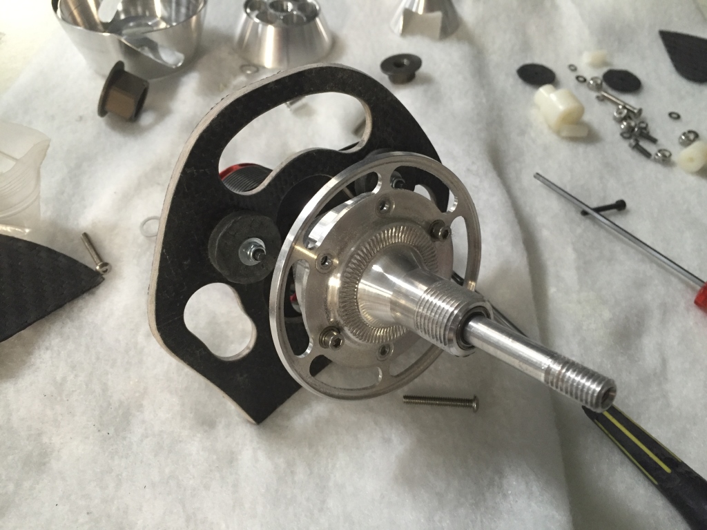

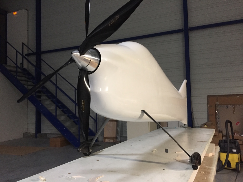

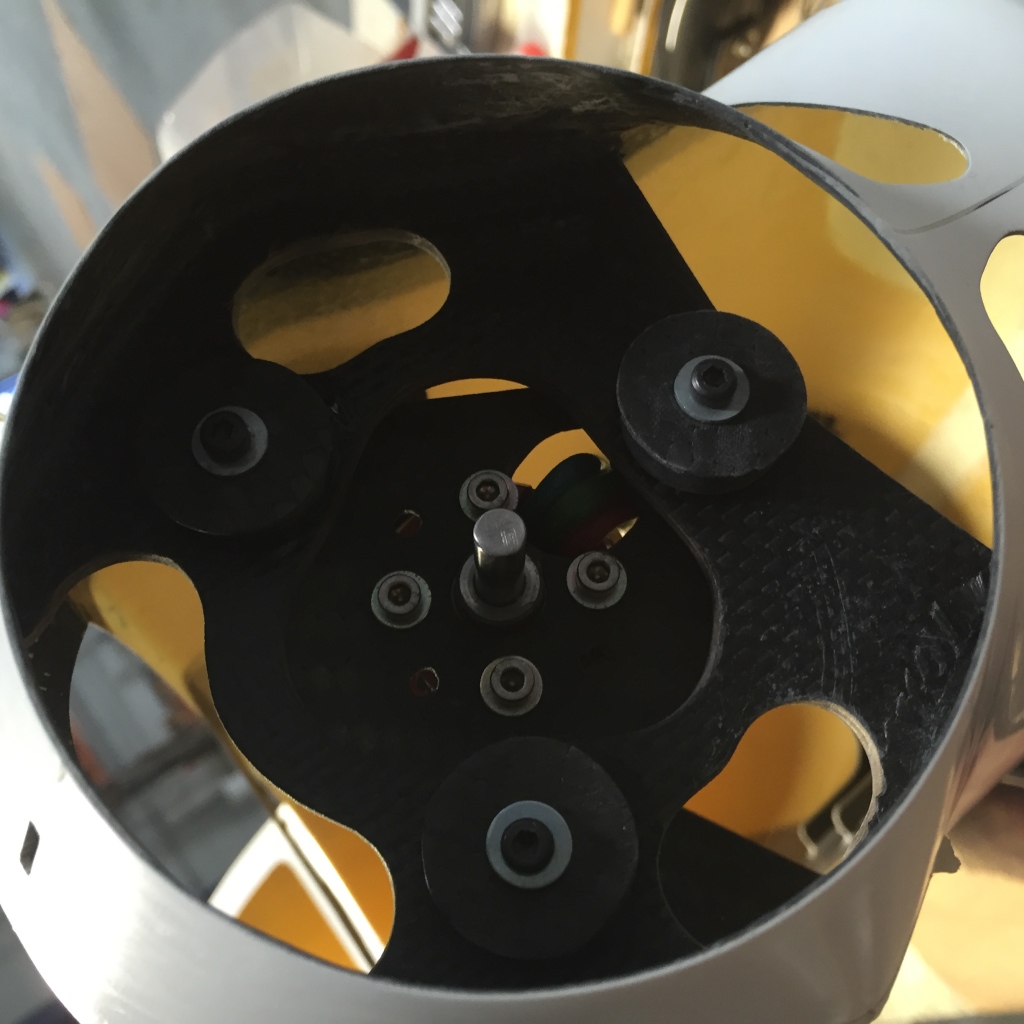

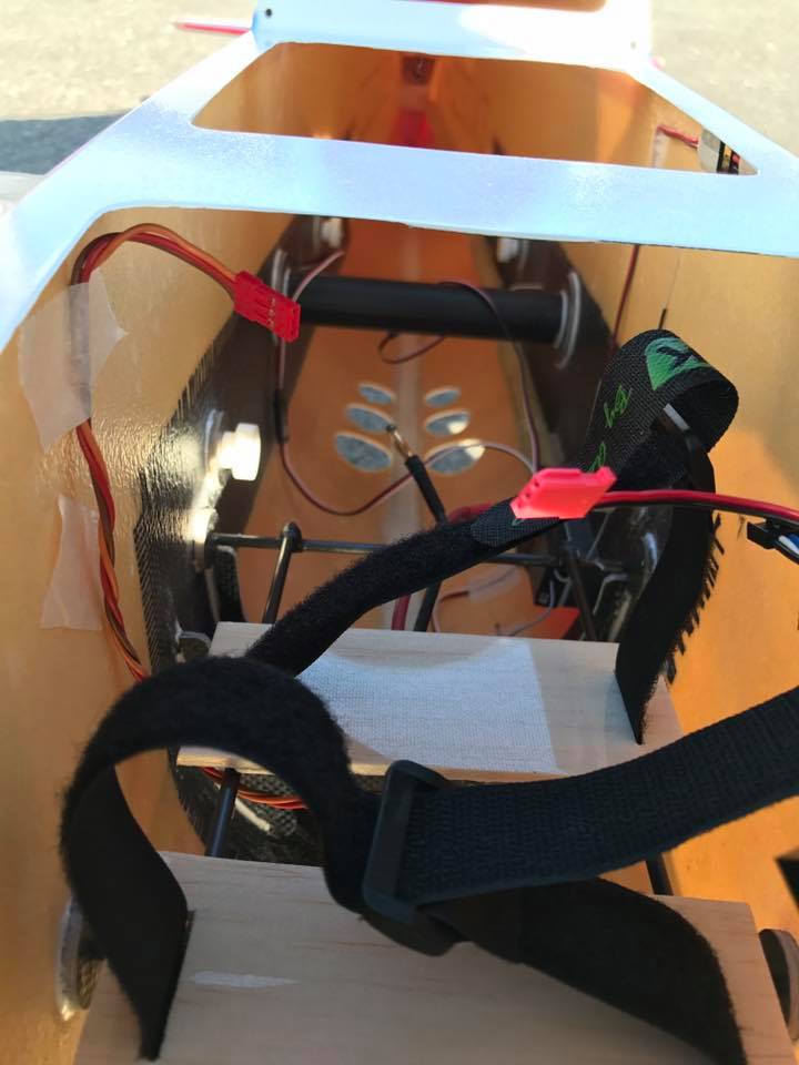

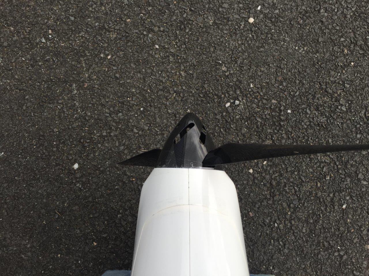

Hello
Installation with Brenner V4

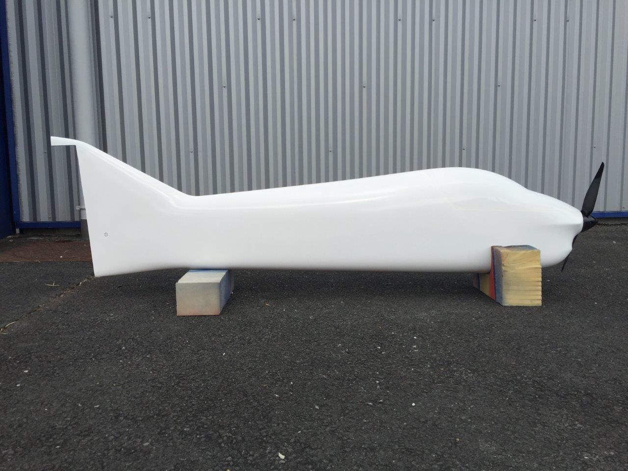

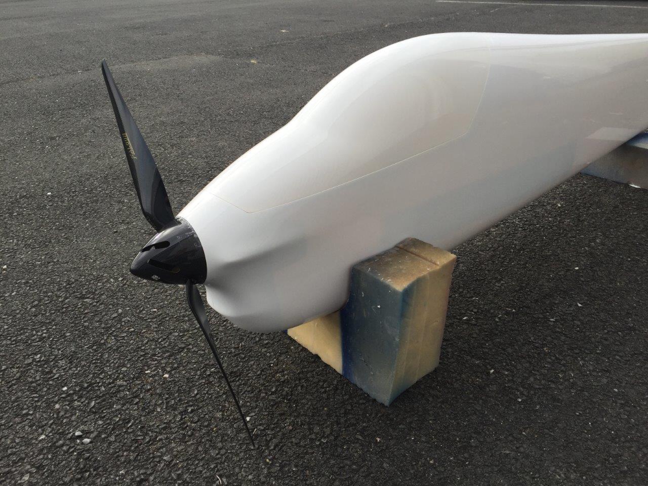

Hello
Wings and stab are installed by Pascal.
http://www.aerocompet.com/index.php?

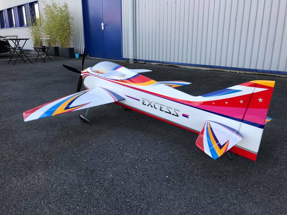

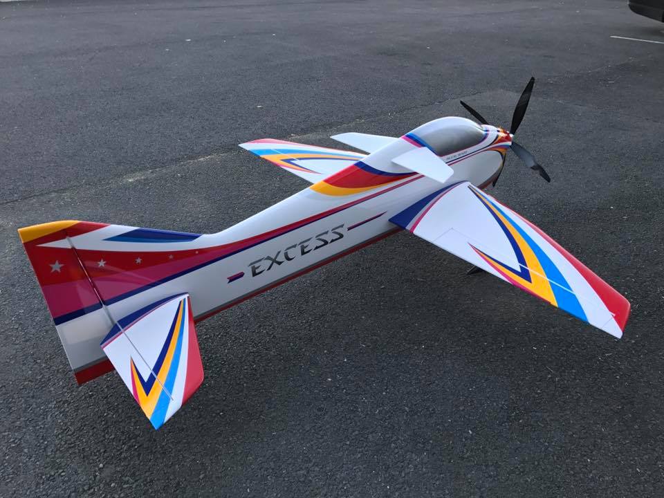

Hello
Pascal did great job himself design, building, painting.

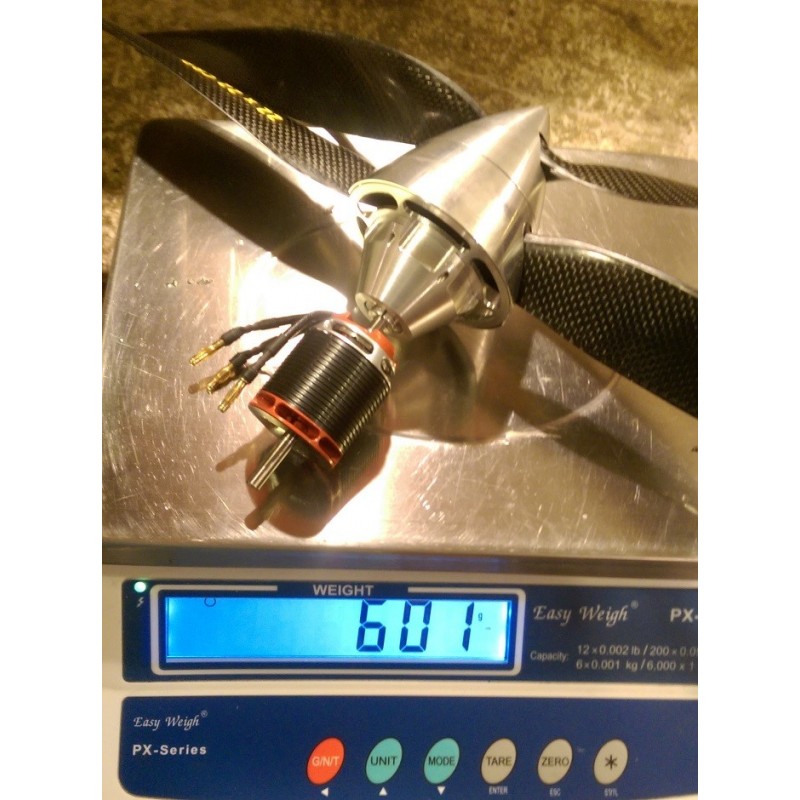

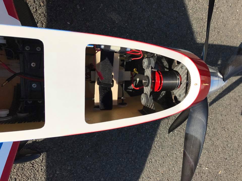

Hello
Maiden flight yesterday
No problem with F17 , knife edge easy like a bip.
Plane is equiped with contra Brenner.
weight : 3590 grs (without motor battery )
servos rudder and et ail BLS 171 HV
servos stab BLS 173 SV
recept R7008 SB
Moteur Contra Brenner V4 + Kontronik 600-09
contrôleur Jeti Mezon 90 lite BEC
propeller Falcon R22 x 20/ F22 x 18
