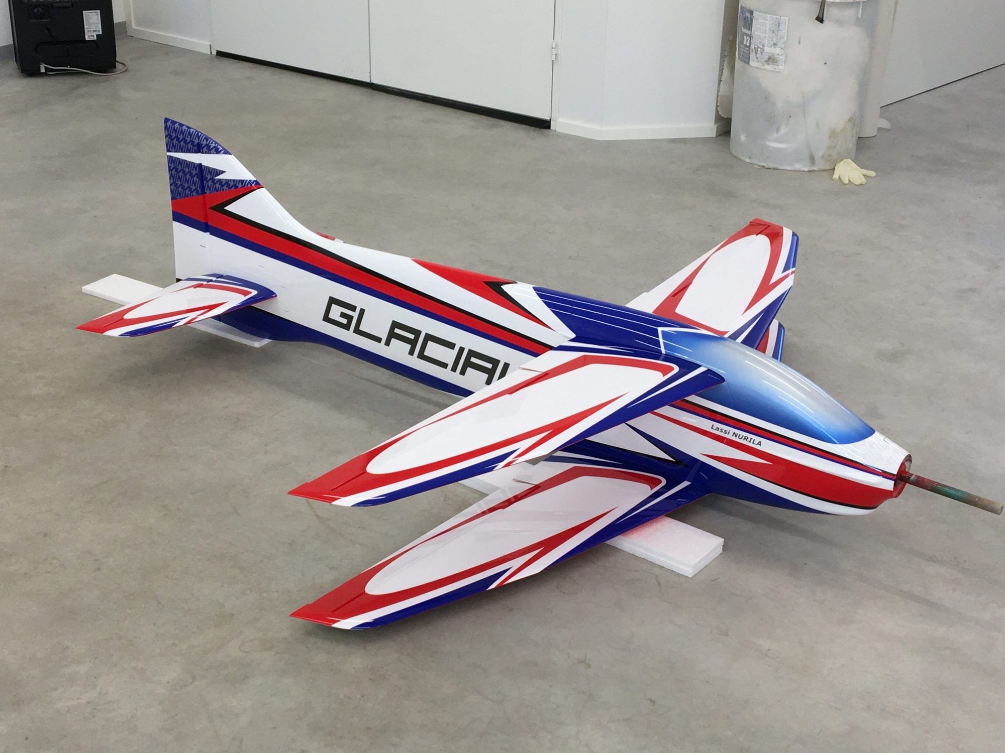

Hello
There is a new Lassi Nurila's pattern biplane named Glacial on his website.
Model kits | Nurila
claude

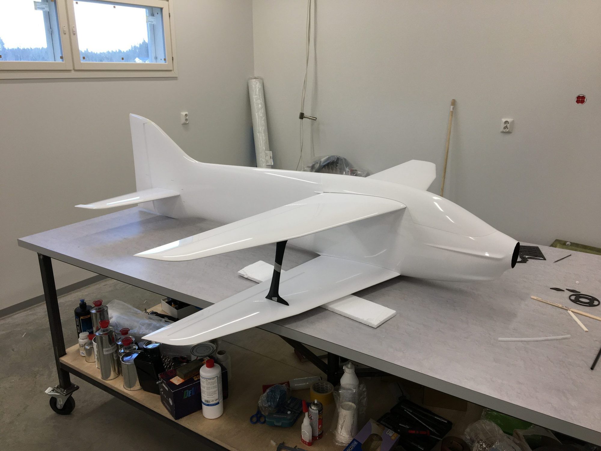

It looks like this design does not use wing struts between top and bottom. Is this true?
The CA Models Andes v1 did not use then
either but their new v2 has put them back in
Is there an advantage to not having them on a biplane?
Old 09-02-2020 | 03:02 AM
ini
Joined: Apr 2003
Posts: 219
Received 11 Likes on 10 Posts
From: , FINLAND
ltc:
It does have the struts.
They are just not shown in that picture of painted result. OTOH that picture doesn't include landing gear either.
About the plane and build quality I can just state just photos are not doing justice to the level of quality.
The plane is a remarkable improvement to previous planes Lassi was flying. Especially in integrated rolls and knife edge flying.

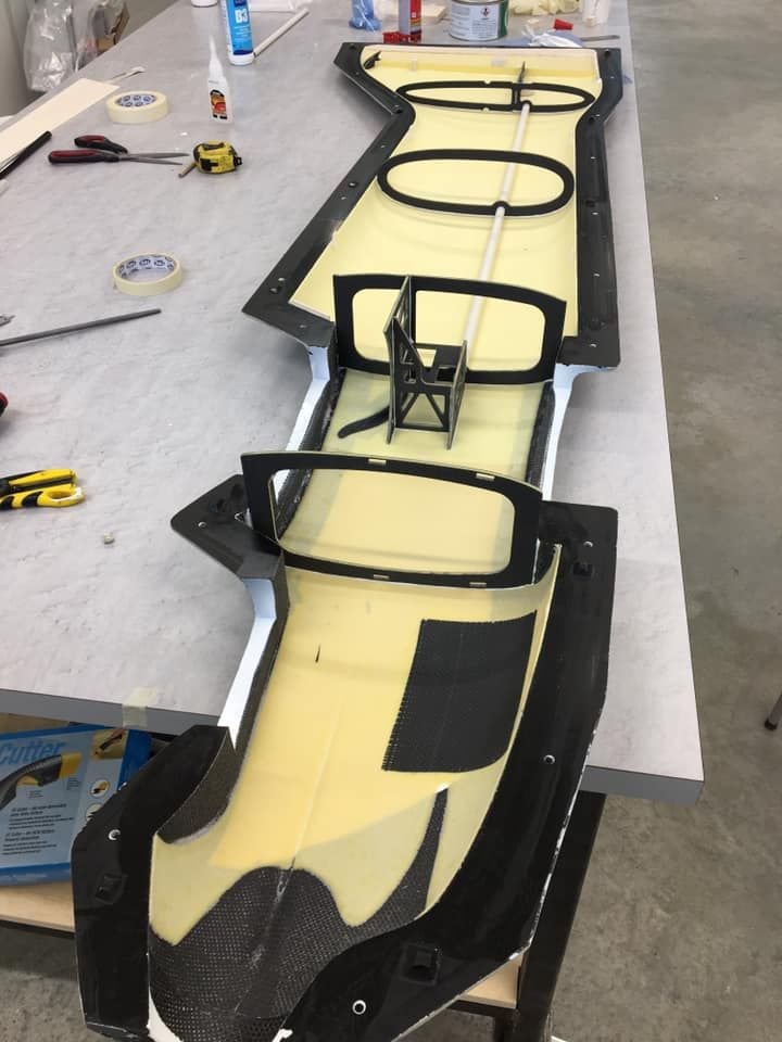

Elevator setup by pull-pull or servos in tail is a matter of personal preference.
IIRC Lassi is preferring pull-pull elevator because of easiness in setup and amount (lack) of maintenance. Also stability of elevator trim is leaning towards pull-pull.
However, everybody is not sharing this opinion (myself included).
Glacial is setup so that both ways are possible. In one of the photos above you can see a paper tube for servo cables going to tail. A bellcrank elevator can also be built if desired. You need to build it yourself though.
