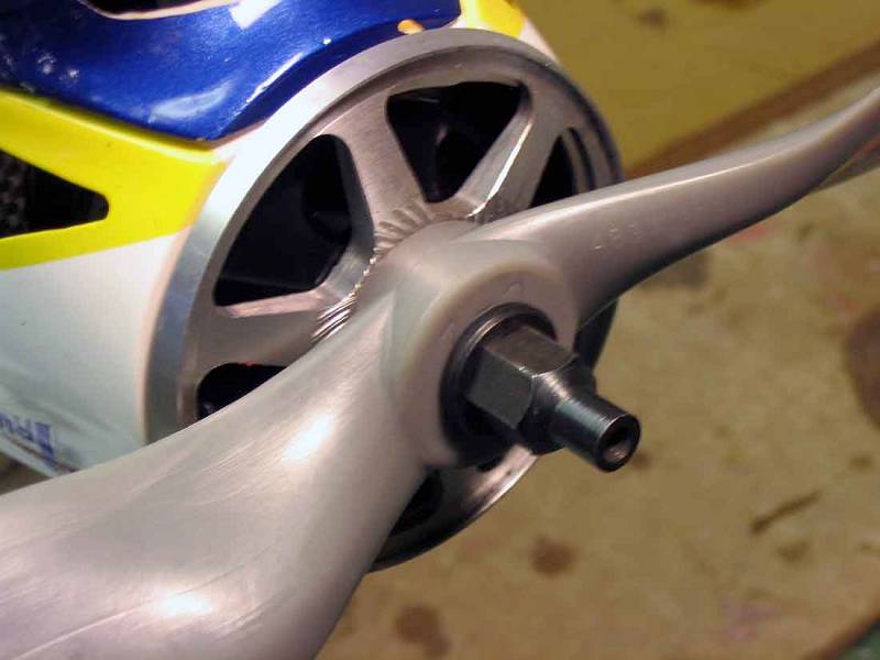

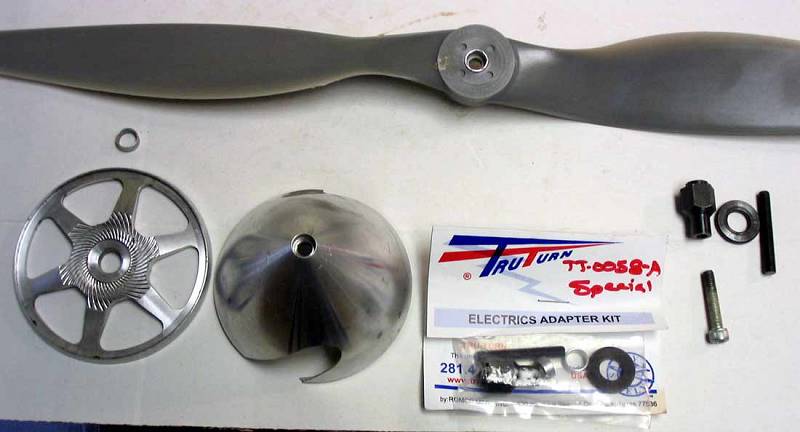

Ex, how are you mounting your prop? Chad and I are using the mounting kit that APC has designed for the Plettenberg Xtra motors. It allows us to use a conventional prop nut and is very simple. If you want more information on it I'll take a picture or two.
RE: 3 or 4 blade Prop for Plettenberg?

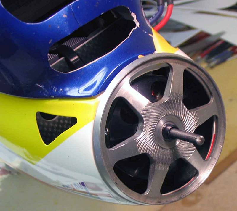

I am using the stock set up that comes with the motor... A threaded shaft that's about 3mm that goes into the motor, and a tru-turn adapter that screws onto the other end. If you have something different, a picture or two would be great.

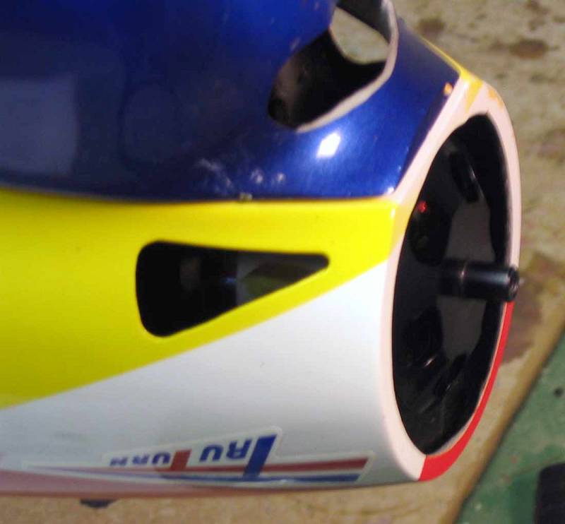

As for mounting the prop... Thread the threaded rod into the motor, place the backplate (washer looking thing with small hole) over the rod until it butts up against the motor bell. Then place prop, with supplied APC plastic adapter to accept the rod, then use the washer and nut to tighten. I don't know who, if anybody, that stocks the Tru Turn adapter. I called True Turn and asked for a Plettenberg adapter and had it in a week.

Thanks Adam for the pics. I ordered the adapter kit. I think I'll be first flying the system this weekend without spinner. One question on tightening the prop. While tightening the prop last night with the stock kit supplied with the motor, it seemed difficult to hold the motor can and tighten at the same time. Have other people noticed this? While holding the prop and spinning the wrench, the motor-can will rotate and not allow too much tightening to take place.

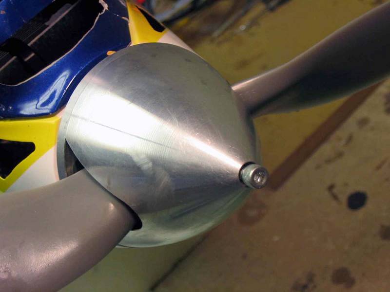

I've flown about 10 flights with the spinner cone off and didn't notice a difference in the air. Big difference in motor temperature, though (thus Chad's modified spinner cone).
I've never used the stock prop mounting system. With the Truturn adapter the prop is locked to the motor can, so I keep the shaft from turning by holding the prop in one hand and wrench in the other.
